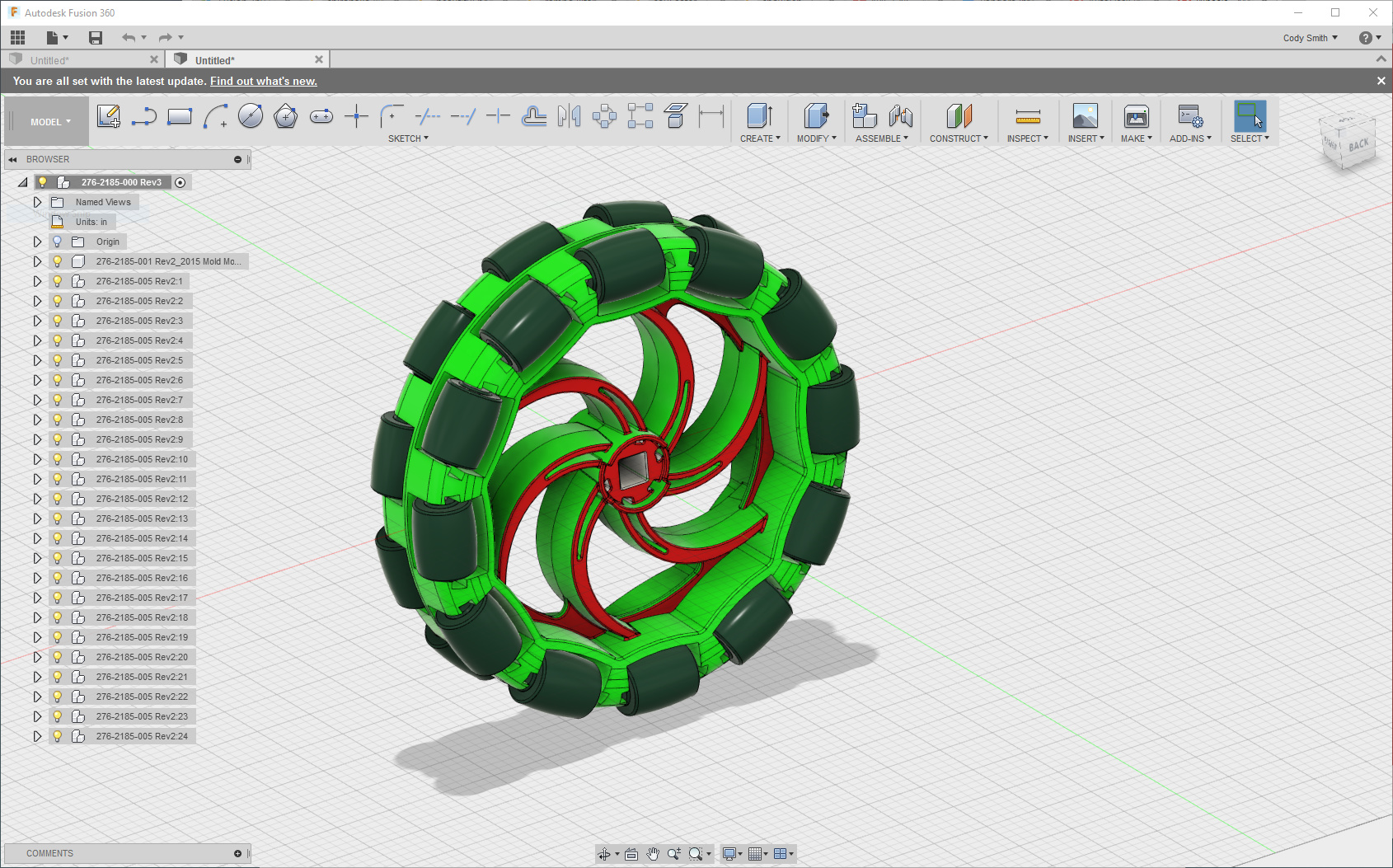

Is Fusion 360 able to import STEP files as well, and, if so, how?
@Cody ^
Let me check…

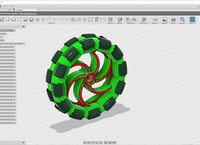

It imported the colors in a strange way, but it definitely works.
Is there a file at that I can import to Fusion that includes all of the VEX parts I’ll need to model a basic mechanism, or do I need to import the parts separately? @Cody
Separately, although there are some premade libraries for Inventor out there. The Bots N Stuff library and I think 254s are popular.
