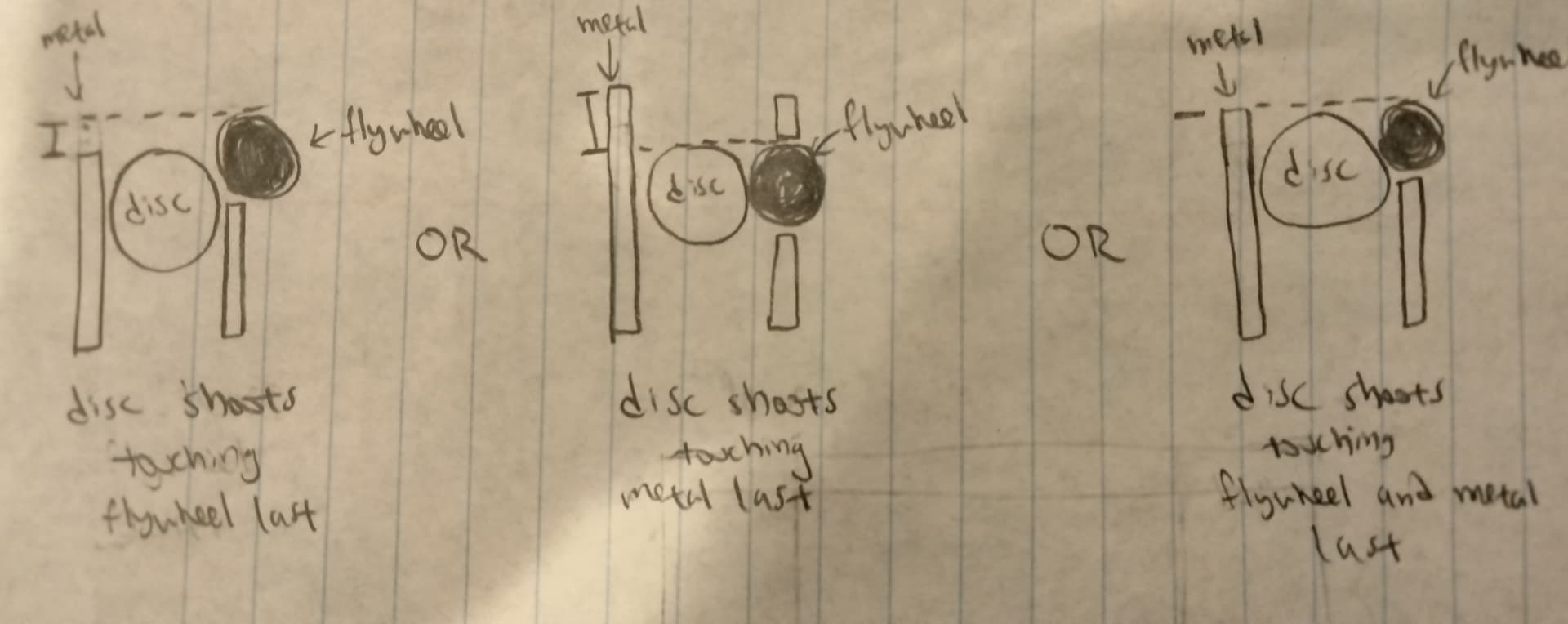

Also, how would I reduce the curve of the disc when it shoots out of the flywheel? Does it have to do with how much the disc compresses, or how long the piece of metal the disc is being pressed on(sketch below)? I’m also using a 2 motor 1 wheel flywheel.

For seeing the effects on the disc as a result of changing the length of how long the piece of metal the disc is being pressed on you should test it yourself and record the data in your notebook (looks very good for judges :)) You are aiming for a soft gentle shot that has as little rpm drop as possible to maximize overfill capabilities and maximum rate of fire.
Build a test rig that is easy to modify between those and maybe other options, design experiments, write them up in your notebook and gain valuable practice at being an engineer :).
