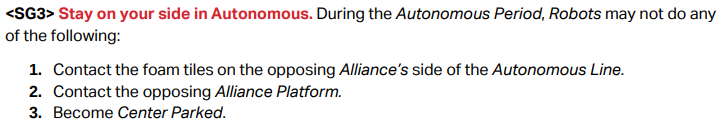

So, I’ve read the rules, and I kmow that in auton, even of you successfully high park without going over the line, you, no matter what, can’t get points for a high park in auton. My team members think otherwise. Which is it?
P.S. I am aware of the correct answer (the first one), I just want to prove it to my teammates.
well if it’s in the manual just show that to them and it should be fine keyword should
straight from the manual
Additionally, violations of the above rule SG3 “will result in the Autonomous Bonus being awarded to the opposing Alliance.” So, if you successfully high park (“become center parked”) it is more than you don’t get center parking points - you lose the Autonomous Bonus (regardless of whether or not you are over the line).

In response to James: Yes, technically as long as you don’t touch the tiles and aren’t center parked, you still get the bonus (if you won). Even if two of your wheels are (technically) over the line, and two are touching the alliance platform, you’re not center parked therefore legal. Sorry about those bad calls.

Yeah, there’s some grey areas about this. To my knowledge, there hasn’t been clarification about what constitutes “becoming center parked” in autonomous. Would it be considered utilizing the center platform in order to gain points? Or just being on the center platform? I had a conversation about this earlier in the year and I doubt I’d be able to find it again.
I agree with the interpretation presented here, where you don’t receive points for being (completely) on the center platform, but also don’t automatically lose auton because of it.

To simplifiy things out a little bit:
Figuring Out Rulings:
  1. Did the robot cross the autonomous line by physically touching the tiles across it? Y/N
    a. Yes - Award opposing alliance the bonus and go to “I” in Actions
    b. No - Move on to 2.
  2. Did the robot center park(Where no wheels are touching any alliance platforms or tiles other than the center platform) at any time during the autonomous period even for a split second? Y/N
    a. Yes - Award Opposing alliance the bones and go to “I” in Actions
    b. No - If there are no violations during the autonomous period, award the team with the highest score for the autonomous period.
Actions:
I. Did the robot in violation intentionally or egregiously push the opponents while crossing or center parking? Y/N
a. Yes - The team(or alliance if eliminations) with the robot in violation should be disqualified from the match, even if not match affecting
b. No - The team with the robot in violation should be warned if they made contact with opponents, but if the robot in violation didn’t make contact the alliance would only lose autonomous.
the rules state that a robot cannot cross the autonomous line or become center parked even if it does not cross the line. it can be partially on the center platform as long as part of the robot is touching the alliance platform and not crossed the center line.
