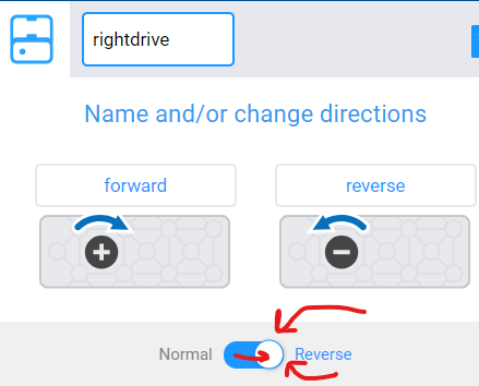

I’m going to assume your left motor does not need to be reversed, but your right motor DOES NEED TO BE REVERSED. This is because the motor is effectively flipped when it’s mounted on the right side, so forward spins the OPPOSITE direction compared to the left motor. Go in and make this change:
And then this is what I meant for the simple test code; it will make the robot drive in one direction until you stop it, but try this:
If you do both of these things, and it goes backwards, then change right motor to be ‘Normal’ and change left motor to be ‘Reverse’.
Ok so, I did what you said, and it does in fact move forward but only when I use the left drive rightdrive , and spins when I use the Pstraight myblock code. I also cannot control how far it goes
