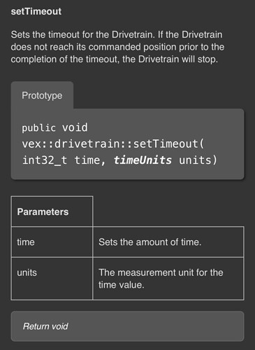

What is the code for the set timeout command for the Drivetrain?
