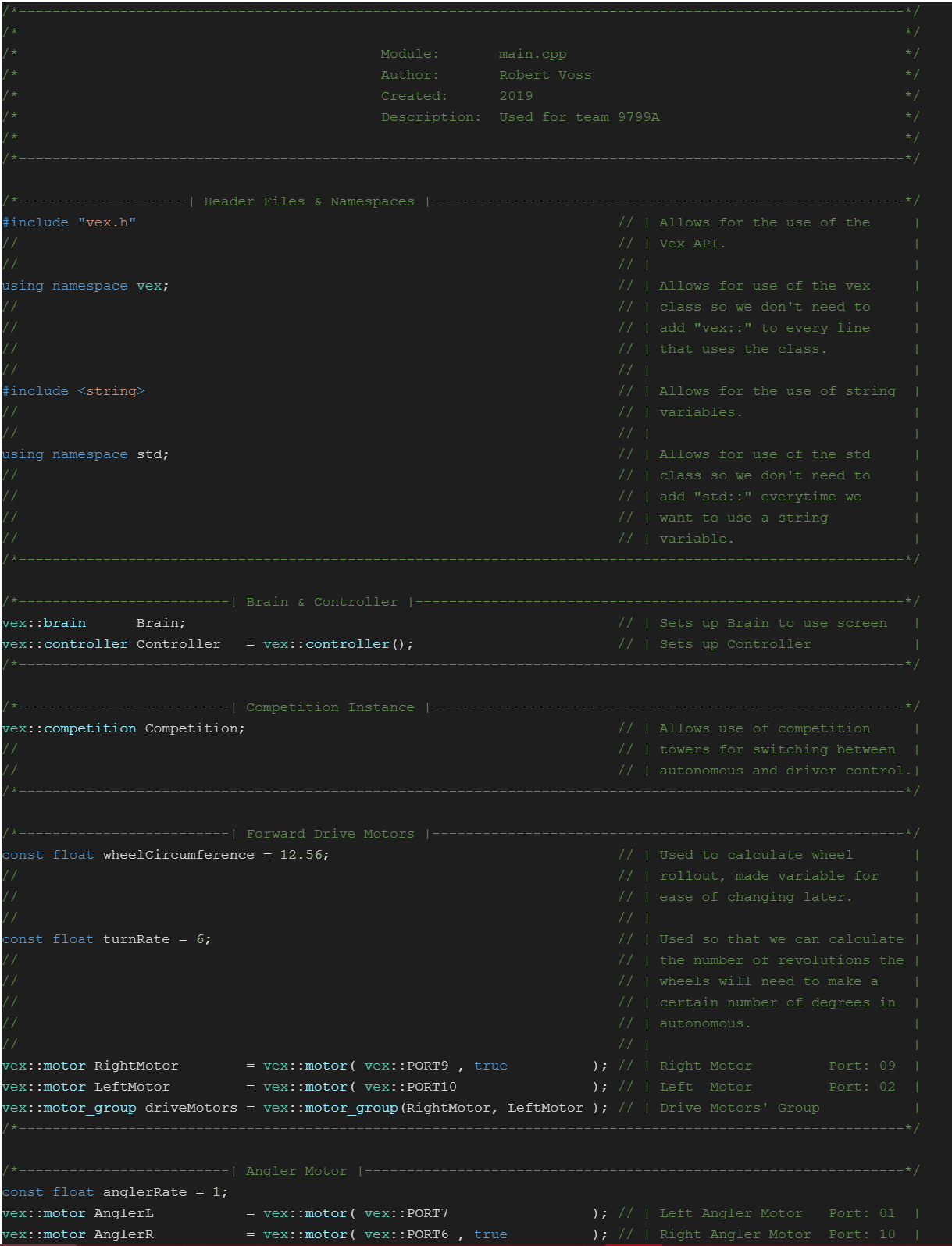

Autonomous help (vexCode Text)
The functions that I created don’t work properly help would be much appreciated. The if statements that rely on strings is what doesn’t work.
/*                                           Module:       main.cpp                                        */
/*                                           Author:       Robert Voss                                     */
/*                                           Created:      2019                                            */
/*                                           Description:  Used for team 9799A                             */
/*--------------------| Header Files & Namespaces |--------------------------------------------------------*/
#include "vex.h"                                                         // | Allows for the use of the     |
//                                                                       // | Vex API.                      |
using namespace vex;                                                     // | Allows for use of the vex     |
//                                                                       // | class so we don't need to     |
//                                                                       // | add "vex::" to every line     |
//                                                                       // | that uses the class.          |
#include <string>                                                        // | Allows for the use of string  |
//                                                                       // | variables.                    |
using namespace std;                                                     // | Allows for use of the std     |
//                                                                       // | add "std::" everytime we      |
//                                                                       // | want to use a string          |
//                                                                       // | variable.                     |
/*-------------------------| Brain & Controller |----------------------------------------------------------*/
vex::brain      Brain;                                                   // | Sets up Brain to use screen   |
vex::controller Controller   = vex::controller();                        // | Sets up Controller            |
/*-------------------------| Competition Instance |--------------------------------------------------------*/
vex::competition Competition;                                            // | Allows use of competition     |
//                                                                       // | towers for switching between  |
//                                                                       // | autonomous and driver control.|
/*-------------------------| Forward Drive Motors |--------------------------------------------------------*/
const float wheelCircumference = 12.56;                                  // | Used to calculate wheel       |
//                                                                       // | rollout, made variable for    |
//                                                                       // | ease of changing later.       |
const float turnRate = 6;                                                // | Used so that we can calculate |
//                                                                       // | the number of revolutions the |
//                                                                       // | wheels will need to make a    |
//                                                                       // | certain number of degrees in  |
//                                                                       // | autonomous.                   |
vex::motor RightMotor        = vex::motor( vex::PORT9 , true          ); // | Right Motor         Port: 09  |
vex::motor LeftMotor         = vex::motor( vex::PORT10                ); // | Left  Motor         Port: 02  |
vex::motor_group driveMotors = vex::motor_group(RightMotor, LeftMotor ); // | Drive Motors' Group           |
/*-------------------------| Angler Motor |----------------------------------------------------------------*/
const float anglerRate = 1;
vex::motor AnglerL           = vex::motor( vex::PORT7                 ); // | Left Angler Motor   Port: 01  |
vex::motor AnglerR           = vex::motor( vex::PORT6 , true          ); // | Right Angler Motor  Port: 10  |
vex::motor_group Anglers     = vex::motor_group(AnglerL, AnglerR      ); // | Angler Motors' Group          |
/*-------------------------| Intake Motors |---------------------------------------------------------------*/
vex::motor IntakeMotorR      = vex::motor( vex::PORT11                ); // | Right Intake Motor  Port: ##  |
vex::motor IntakeMotorL      = vex::motor( vex::PORT20, true          ); // | Left Intake Motor   Port: ##  |
vex::motor_group Intakes     = motor_group( IntakeMotorR, IntakeMotorL); // | Intake Motors' Group          |
/*-------------------------| Tray Motor |------------------------------------------------------------------*/
const float liftRate = 1;                                               // | Allows us to lift the tray up |
//                                                                      // | For stacking.                 |
vex::motor TrayMotor         = vex::motor( vex::PORT2                ); // | Tray Motor          Port: 11  |
/*                                         | Pre-Autonomous Functions |                                    */

this is the actual code, the picture didn’t work right.
