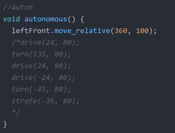

So I am trying to program an autonomous for our robot. I sent the code to our driver and the autonomous at least did something on his brain set. I picked up my own electronics set, and now, the autonomous doesn’t respond at all. It won’t even do a basic task like spin a motor. I’ve tried downloading to different slots, firmware is up to date, I tried with PROS and VexCode, I’m on the competition template, but nothing works. Everything is fine in driver control though.
Any help would be greatly appreciated.

Could you post your code?
Screen Shot 2020-05-21 at 11.25.07 PM
That shows very little as it’s just a function that’s defined elsewhere. I would suggest putting simple a motor.spin command for an available motor and see if it spins. If it does, it’s a problem, and if it doesn’t, it’s a problem with the brain/controller/downloading.
Oh yeah, I tried that as well earlier. I tried to rule out a downloading issue by making the controller do a different vibration pattern at startup, and that works fine
Thank you so much! We had a team meeting and figured out that it’s because I wasn’t “building” the PROS project before uploading it to the brain.
