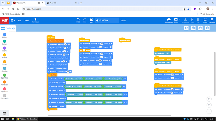

My students and I are not sure why, but this code (attached) will not start its auton run on the field. We can’t figure out why, but hoping the community has some answers.
All the code under “when started” hat will still be running, if that is supposed to be driver control, move it under the “when driver control” hat
Is it really that easy? Ok I will pass this along to my student. Thank you!
