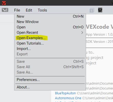

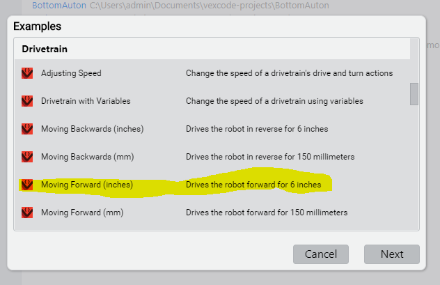

Hi all! I have a competition in a few hours and am wondering if you can spare me your autonomous code (if you want to). If so, I can base it off of that. Thanks!
Based off the title, I’m assuming that you just need an auton that can run forwards and backwards. In that case, I recommend you base it off of one of the clawbot examples (pictures shown below). If you do need more help in making your auton, feel free to PM me.
