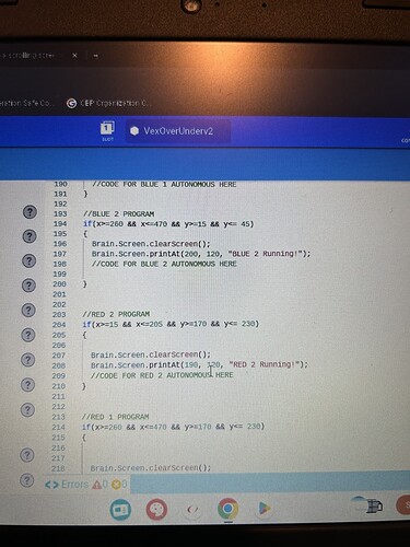

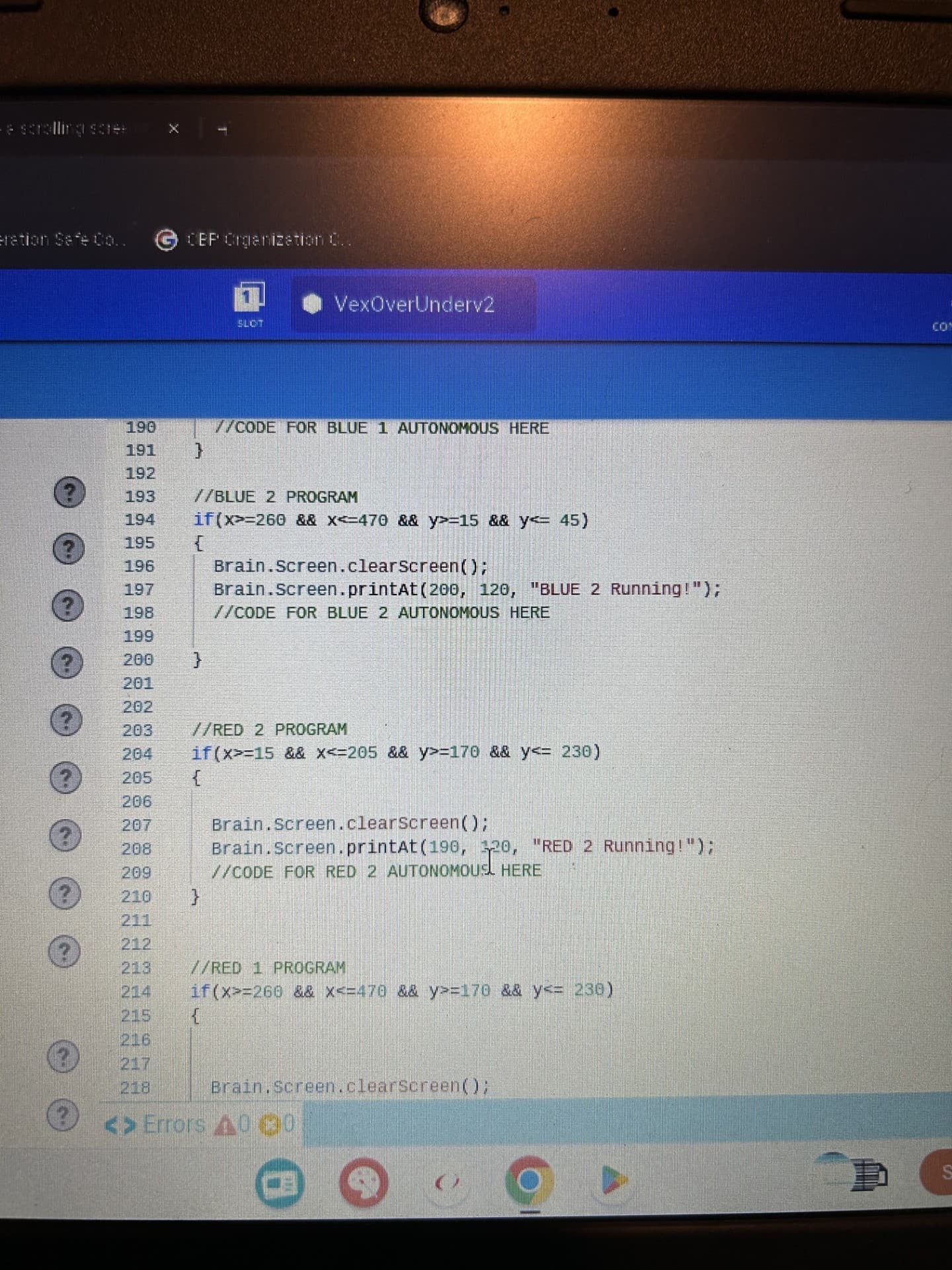

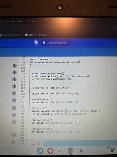

This is the whole code in PDF format. The autonomous program runs twice but I just want it to run once. It basically just loops again.

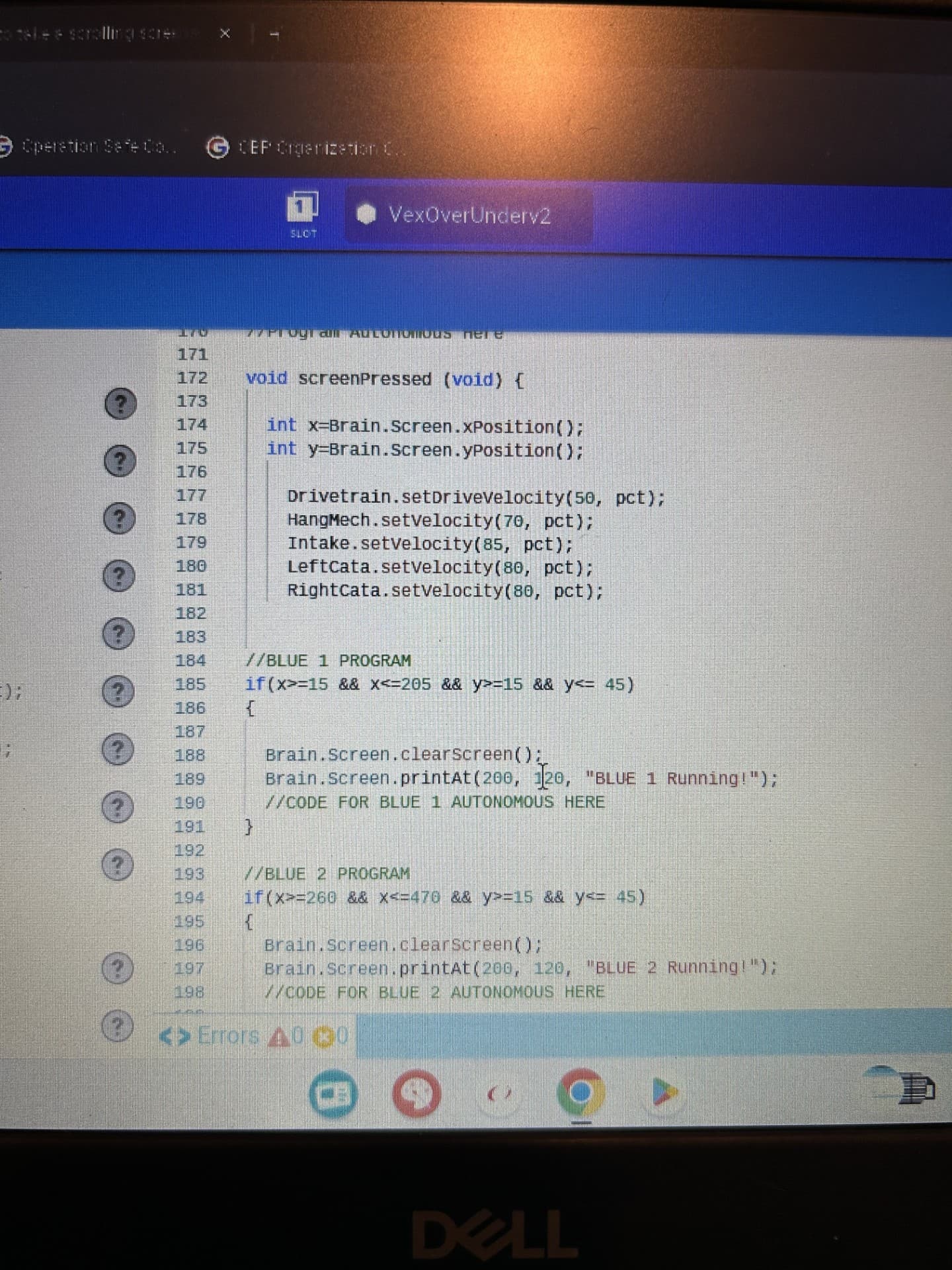

looks like you run “ScreenPressed” for two different things. Once when the actual screen is pressed and again when the autonomous part of the match is enabled.
This may not be the root cause of the auton sequence running twice (it all depends on how you are triggering autonomous) but you should really separate the auton selection from the function that runs the code.
How would I go about separating my autonomous selector?
