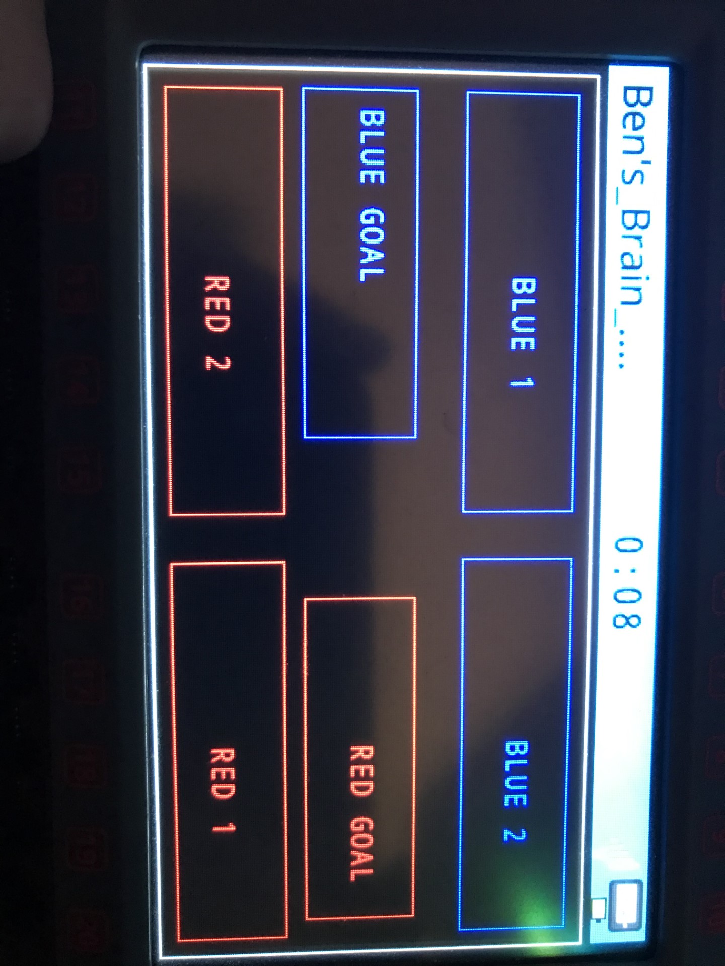

So I have made it this far now. I have written code to draw the over under field on the V5 brain in the pre-autonomous area. But based off of the links that you have sent me, I can’t comprehend what to do next. The end goal is for me to press one of the buttons on the V5 brain, either “RED 1,” “RED 2,” “BLUE 1,” or “BLUE 2” and execute code for autonomous. I don’t know how to code the next steps. Thank you for all the help.
You can use the vex::brain::lcd::pressed() or vex::brain::lcd::pressing() functions to detect press interactions on the screen.
  • pressed(void(*callback)(void)) registers a callback function that should be executed every time the screen is pressed.
  • pressing() returns a boolean value that represents whether or not the screen is being pressed at the time the function is called.

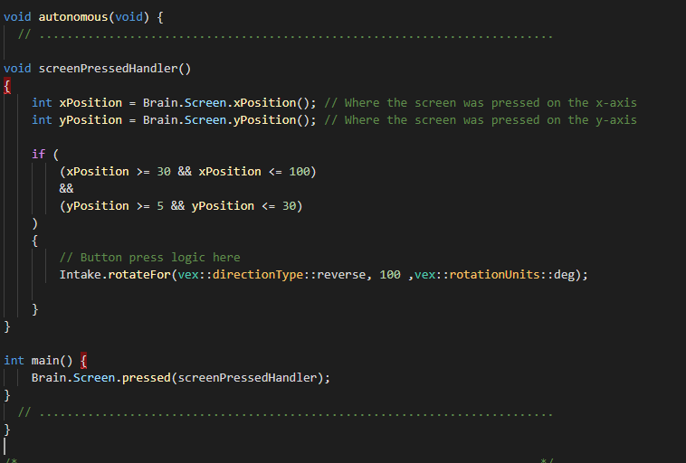

When I finished the program for my autonomous selector, I got an error highlighting the curly braces saying “Function Definition Isn’t Allowed Here.” What does this mean?
In C++, you cannot define functions within other functions.

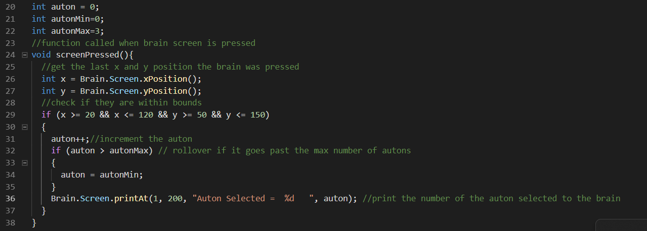

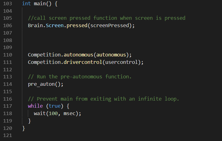

I have written this code so far but when I go to press a button on my V5 brain, nothing happens.
Here is some relatively simple example code. Please try and take the time to understand what is going on and I am confident you will be able to find a way to adapt this to make your current code work
why your previous code doesn't work
The code is almost there but not quite. The xPosition and yPosition functions get the last spot the brain was pressed but where you have them they will never get updated or called by vex because they are not inside of a function. Using a function callback to detect when the brain is pressed and call a function (that updates your x and p positions) will update your values correctly.
