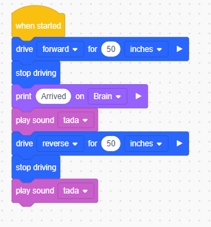

Recently, our team has been working on our autonomous program. Our program is designed to drag the neutral mobile goal in front of where the robot has been placed back into the home zone.
Our program works perfectly up to the point where it is supposed to drive in reverse. After that point, the robot stops and doesn’t move backwards. I’ve tried almost every solution under the sun, and nothing has worked. If anyone has any ideas on what could be going wrong, please share!
Most likely, it is getting “stuck” on the “drive forward line for 50 inches” because something physically stops the robot from going the full 50 inches…so it just sits there waiting.
We’ve already tried that. The robot isn’t getting stuck on anything as far as we can tell, and it is going the full 50 inches (we have measured this).
If you pick your bot up during the “drive forward” segment, does it “reverse” after it thinks it has gone 50 inches?

The code looks fine. I can’t see any issues with it and I’ve been using block codes that work almost the exact same way for 6 years.

Add some diagnostics to test your code. In the example below I added Print to screen and a Play Sound. If the code is working it should play a sound before moving in reverse. If it doesn’t then there is a problem in the code before the sound.
Thanks! I’ll try that. (20 char)
have you tried just making the motors run reverse by itself? than slowly adding back the code until it doesn’t work? i know it can be quite tedious, but that is how i have fixed problems that no one could find.
