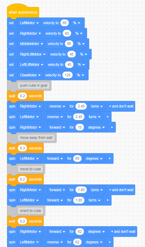

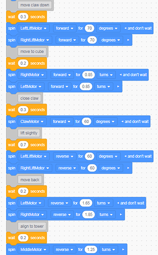

Our autonomous stops at a certain point. We are using V5Blocks. It works whenever we restart the controller and brain. I don’t think it is an issue with a block, never completing it’s task and causing the code to run forever. Any help is appreciated (we have tournament tomorrow).

codepart1
codepart3
codepart4
Where is it stopping? Overall the code looks ok.
Tip: increase your wait statements to 3 seconds. Then you can visually tell when something has finished. Afterwards you can reset them back to fractional seconds.
You could also send a ‘beep’ command after each ‘section’ of code. that will let you know it’s finished.
I’m not super familiar with v5blosks. Modkit has a statement for a motor to start to move to a certain degree, but NOT stop the code if it can’t complete.
Make sure all your values are being able to complete
