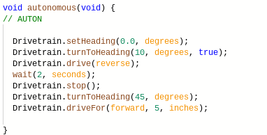

In our most recent competition, we noticed that when turning in autonomous the robot tends to turn really slowly like 8/10 times. This isn’t much of a timing issue right now, but it can make my later auton plans more inconsistent.
I am using the built-in vexcode drivetrain class because we have a 4 motor drive and it is just easier, along with an inertial sensor. Code wise, I use the turnToHeading and turnFor lines and it’s turning velocity is set to 100%.
Why could this be happening and how could I fix this?

Then maybe it’s a programming issue. Would you mind posting the code? I’m not a pro but some people on the forums are…
Here
We tested it again yesterday and it still happened.
