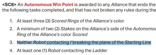

Thank you for helping to clarify. I was feeling like legal starting position and updated AWP criteria were conflicting with each other, which is why I posted. Here is what it says in the AWP section.
Screenshot 2024-09-27 111551

Yes, both robots must start breaking the plane of the Starting Line, and to achieve the AWP, both robots must end up off the Starting Line.
So, it’s an additional challenge for the AWP (both robots need to run an auton that moves them forward).
