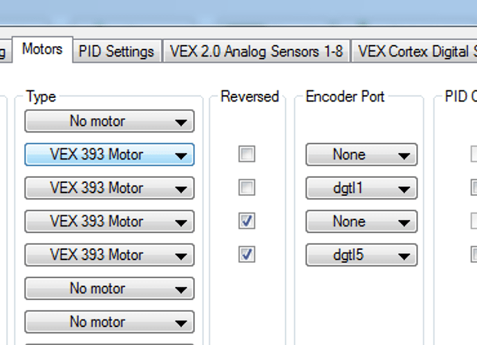

If you’re using quadrature (not quadratic; no such thing) encoders and tank configuration, it’s good to have two. (But you can get by with one.)
Here’s how the motors and sensor setup screens look for a typical 4 motor, 2 quad sensor setup:
First, the motors:
And here’s how the pragmas look for that setup:
#pragma config(Sensor, dgtl1,  rightEncoder,   sensorQuadEncoder)
#pragma config(Sensor, dgtl5,  leftEncoder,    sensorQuadEncoder)
#pragma config(Motor,  port2,           rightfront,    tmotorVex393_MC29, openLoop, driveRight)
#pragma config(Motor,  port3,           rightrear,     tmotorVex393_MC29, openLoop, driveRight, encoderPort, dgtl1)
#pragma config(Motor,  port4,           leftfront,     tmotorVex393_MC29, openLoop, reversed, driveLeft)
#pragma config(Motor,  port5,           leftrear,      tmotorVex393_MC29, openLoop, reversed, driveLeft, encoderPort, dgtl5)
