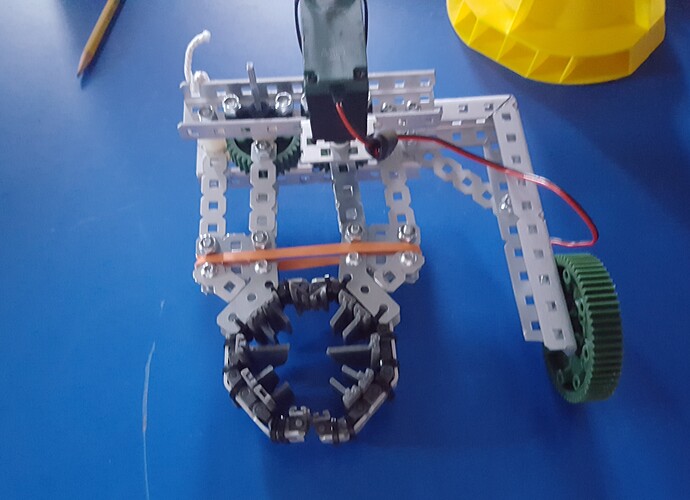

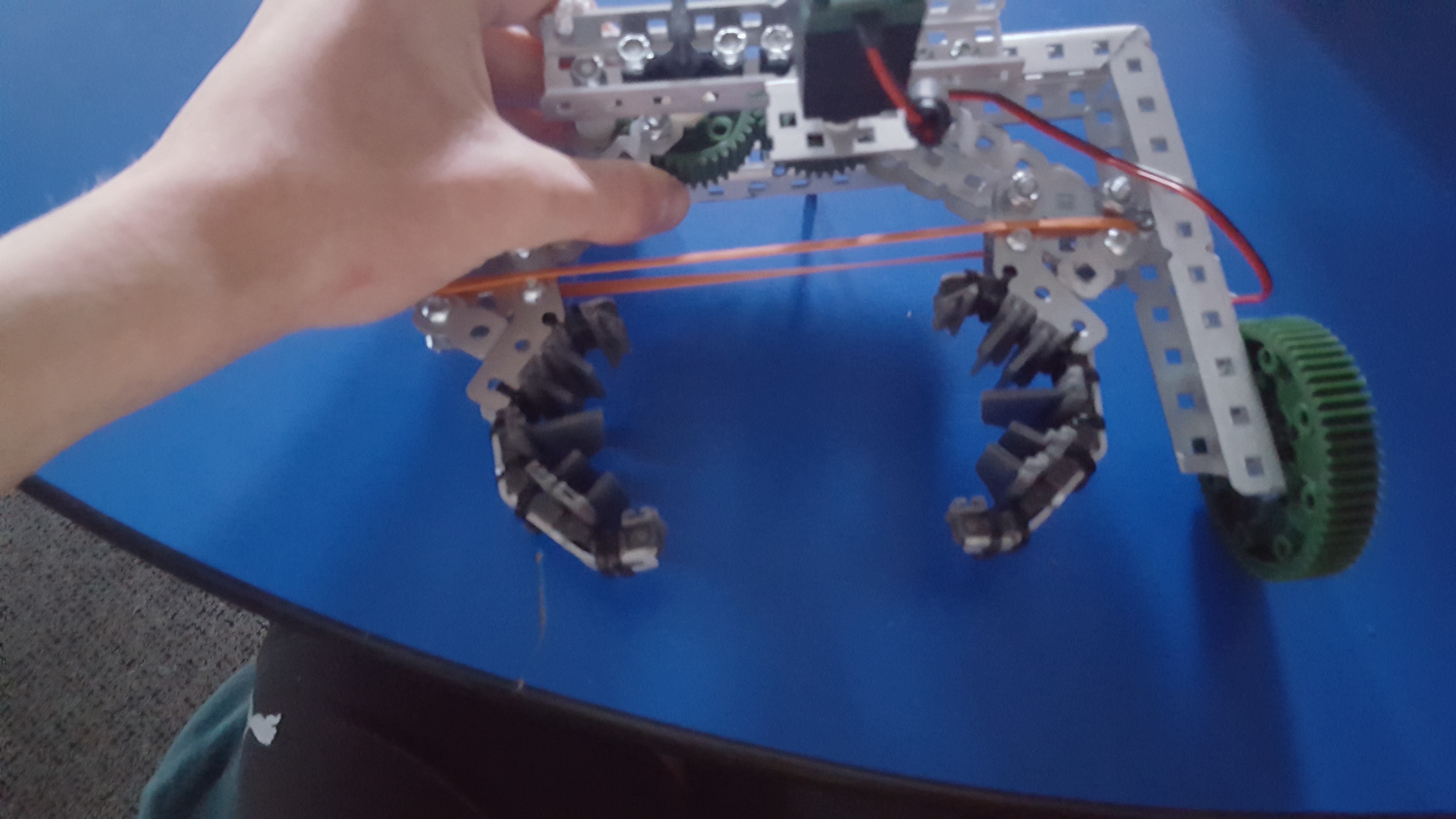

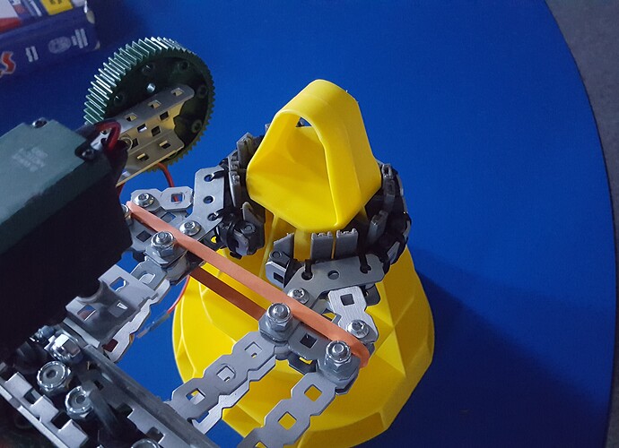

Awesome cone grabber design

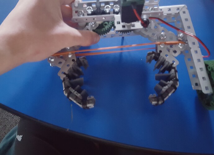

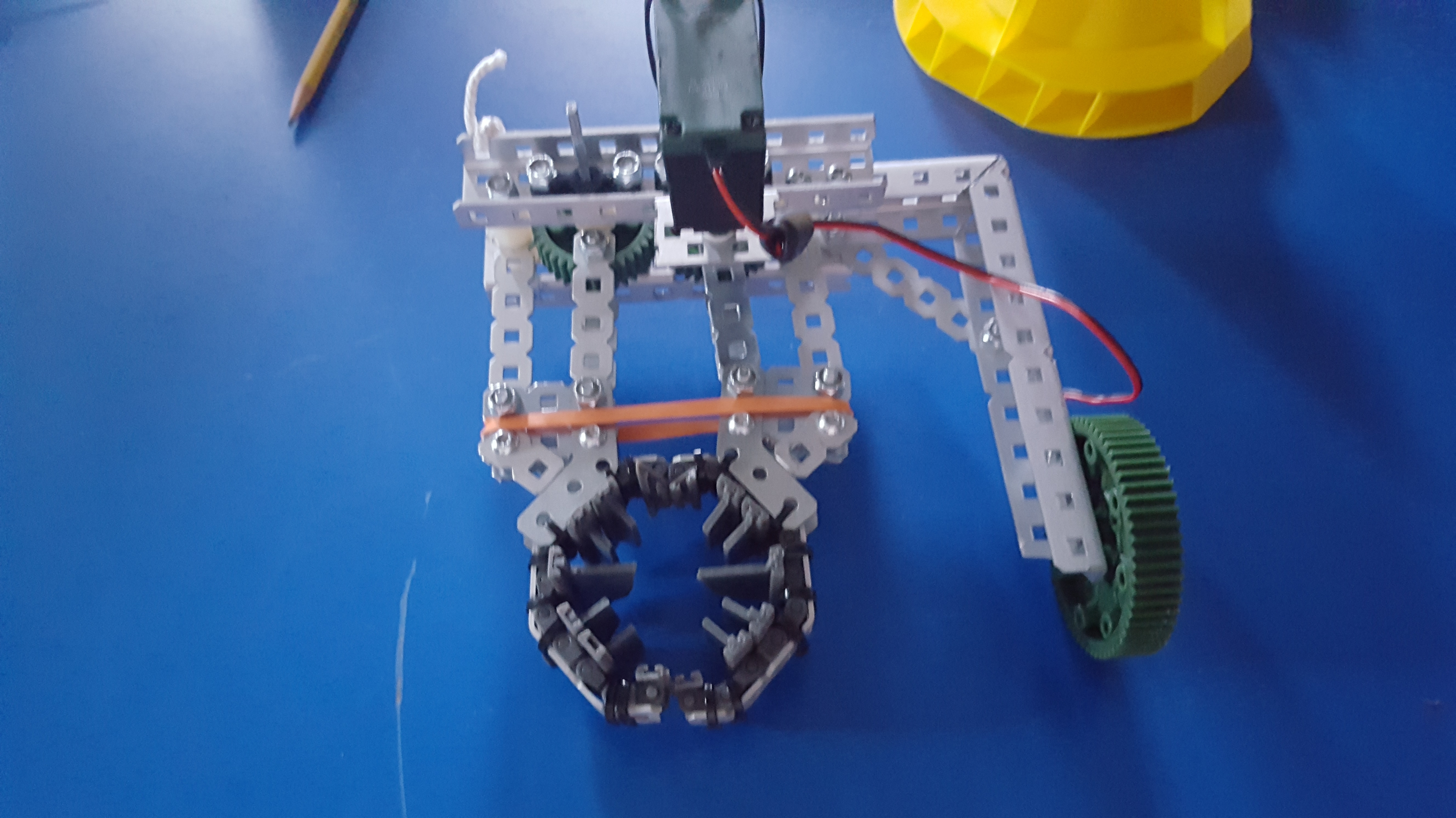

Here’s the cone grabber I designed, it easily grabs cones from any angle and cones that are on the ground, first time, every time. :smiley:
so its a claw, with some fancy cut rubber flaps? how are you planning on getting it onto bases
IIRC, he’s planning on using a different mechanism for manipulating mobile bases
But will he move the entire stack every time, thats the problem with side claws is you have to release weird
Nice Design!
@antichamber How well does it pick up fallen cones?
Perfectly, I haven’t had it fail unless it is in the wrong position to grab yet
how does it pick up fallen cones?

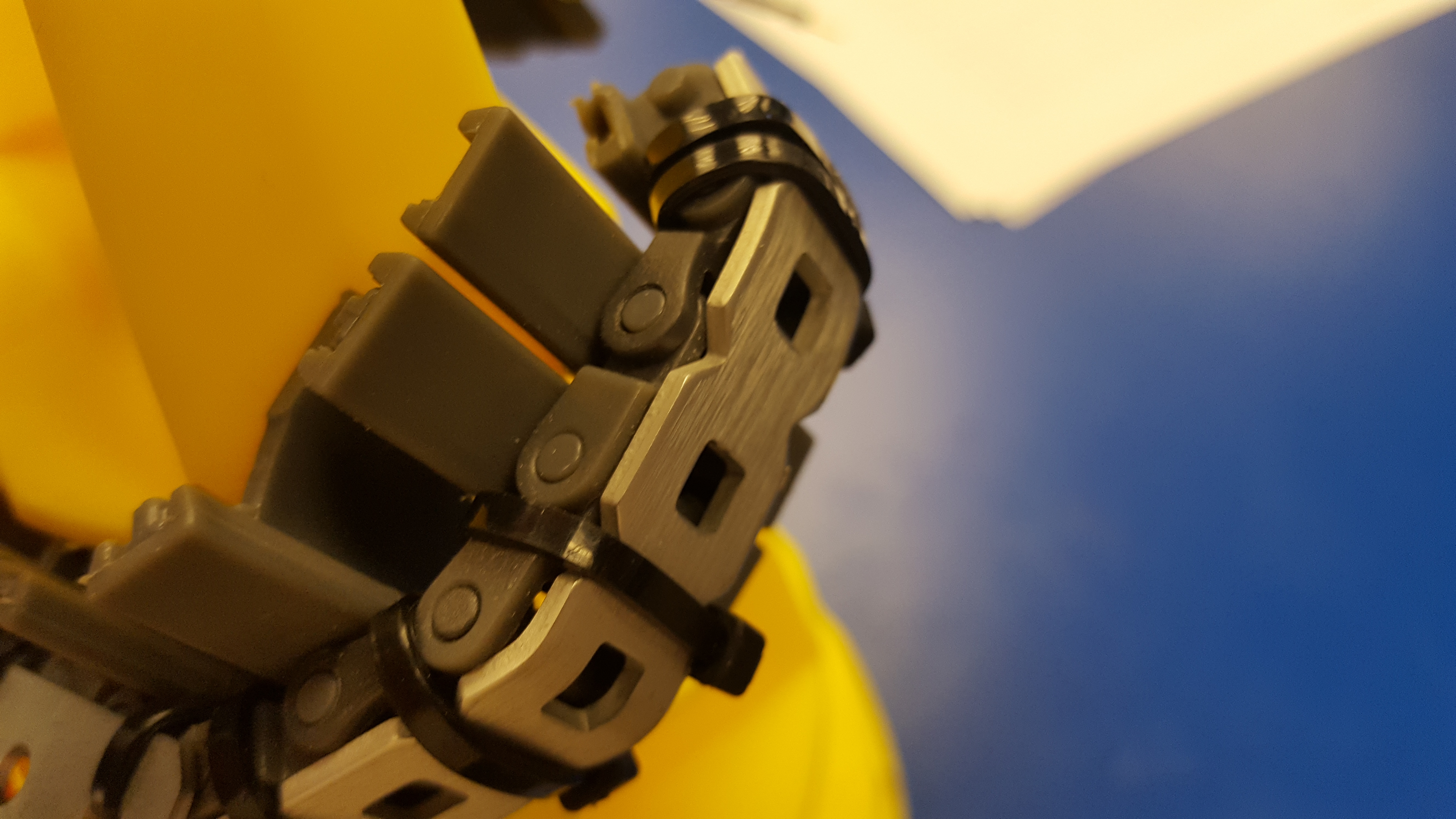

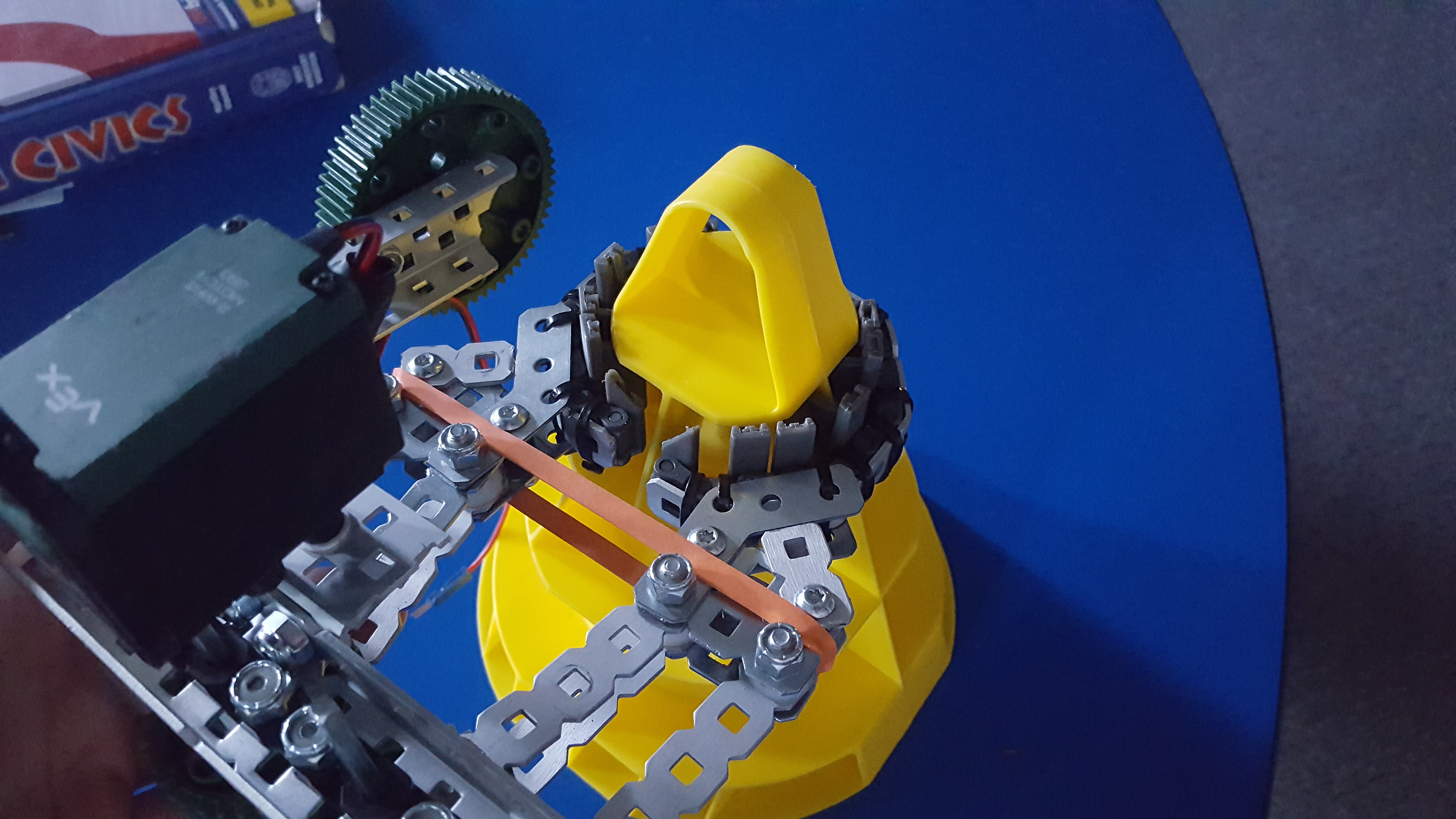

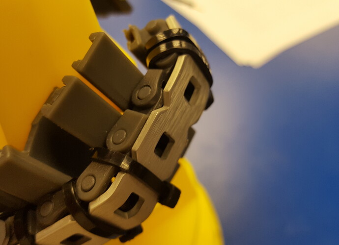

@antichamber Btw do you happen to have a more side on view of the grabber, it’d be really helpful, as I cant tell what the side aluminum portion is made of
Edit: it looks like 1x but im not sure, and i cant tell how the flaps are attached

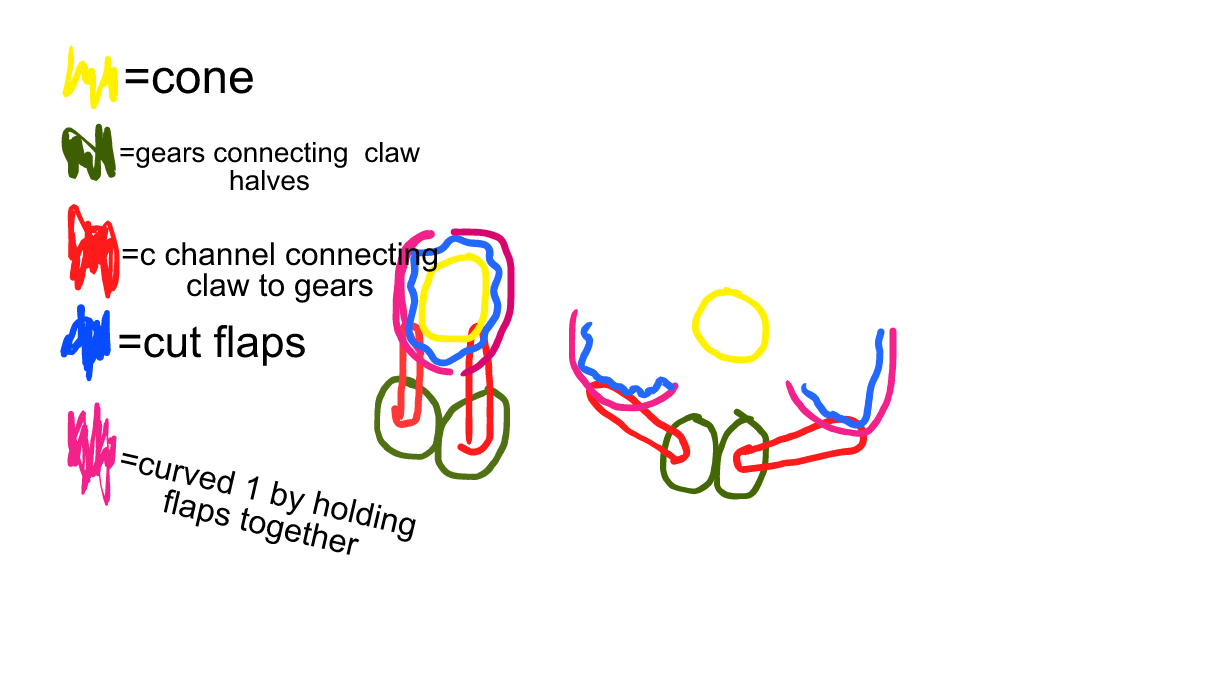

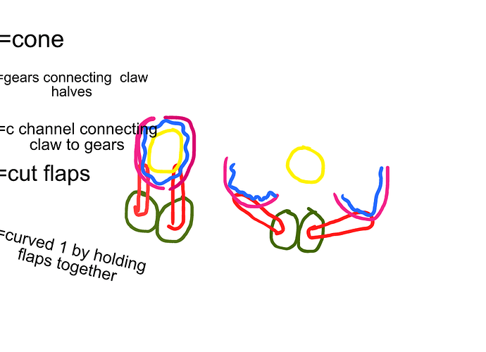

edit 2: it seems like you could grab cones better if the claw was attached to a single piece of metal, similar to how reverse dumpers were last year, as it would funnel cones into the claw better, and grabbing would remain unnefected

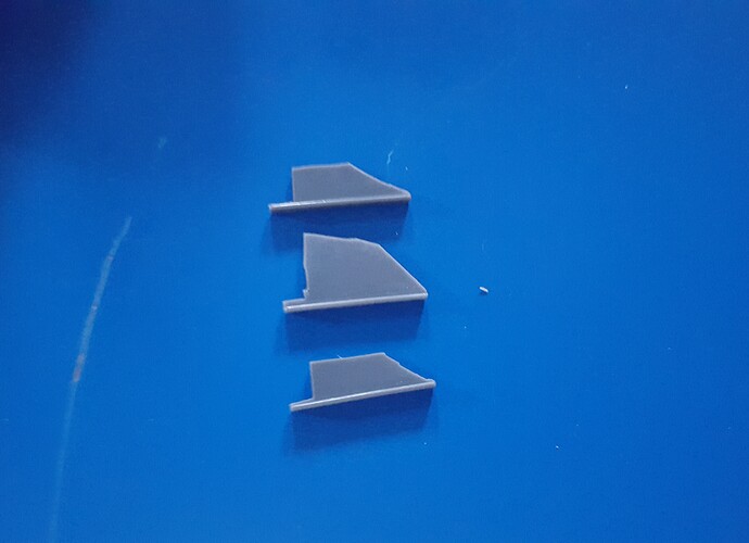

The flaps are connected with chain that is zip tied to the metal.

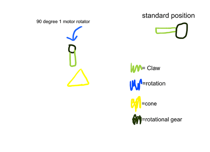

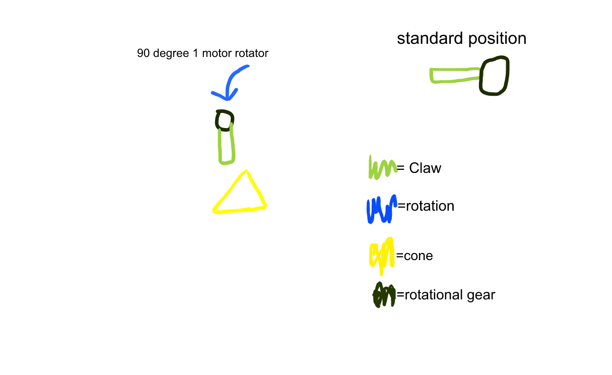

@antichamber I am a little confused about the thread you posted so can you provide pictures on how it would rotate fallen cones? The diagrams are helpful but pictures with the actual mechanism would make it incredibly clear
i’ll do one real quick<br>
1x bar, attached with zip ties

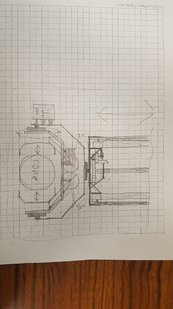

Please draw a diagram of what you mean by “claw attached to single piece of metal”
like this is what i mean
