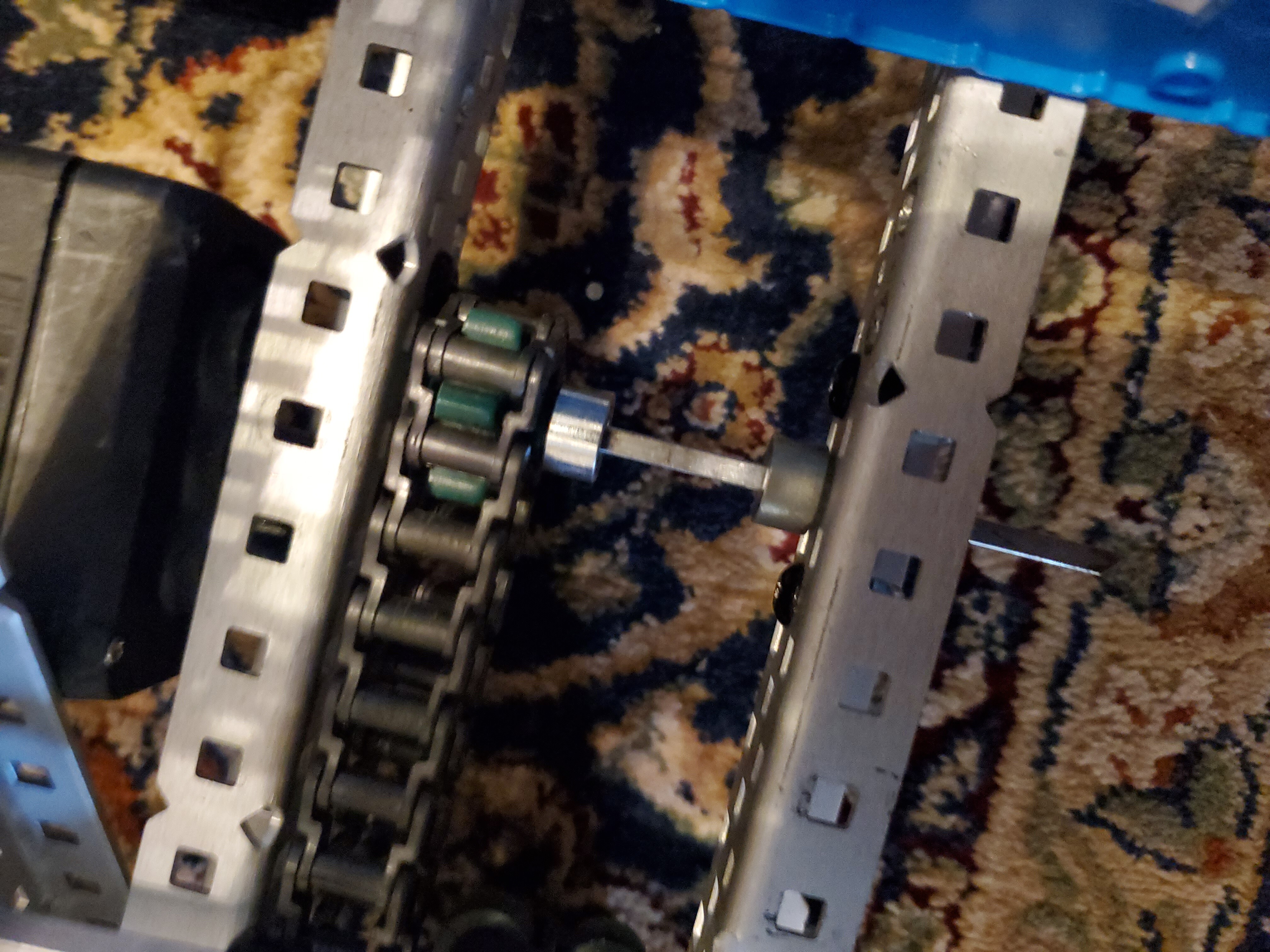

I just want to understand how to make sure the axel (which the wheel lies on) won’t come off the motor.
I just want to know how to make sure an axel won’t fall off a motor easily
Thanks for the input, but though I put many of those on, the axel still falls off
Could you send a picture and or video of the issue so we can better understand what the solution might be

If the shaft collars don’t work (they should work just fine), you can try using the axles with the offset flange. You’ll probably want metal axles for this if you can. Also make sure you are supporting the wheel on both sides.
Thank you for your valuable input!
Push the axle into the motor with you nonwriting hand and then with your other hand screw in the shaft collars in tightly. Here is an image for where the shaft collars should go.

Thank you so much for the picture!
