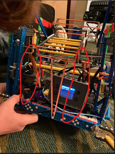

Our catapults turning point is mounted on a shaft. However due to the tension placed on the catapult it’s causing the shaft to flex which in turn causes our entire bot to flex. How do we prevent this without adding significant weight to our bot?

Can you build out from the supports so there isn’t such a huge distance between the support and the catapult? From the picture it looks like you have 2" gap on either side.

So you mind sending a photo I don’t quite understand, but yes we will add more cross bracing
The shafts that are the points where it connects -
What are those? It looks like shafts that go through 1 hole but they do not connect together. Wouldn’t you want the shaft to go through the entire catapult?
It just likes like that it’s actually a 12 inch shaft that goes all the way through you just can’t see it from this angle,

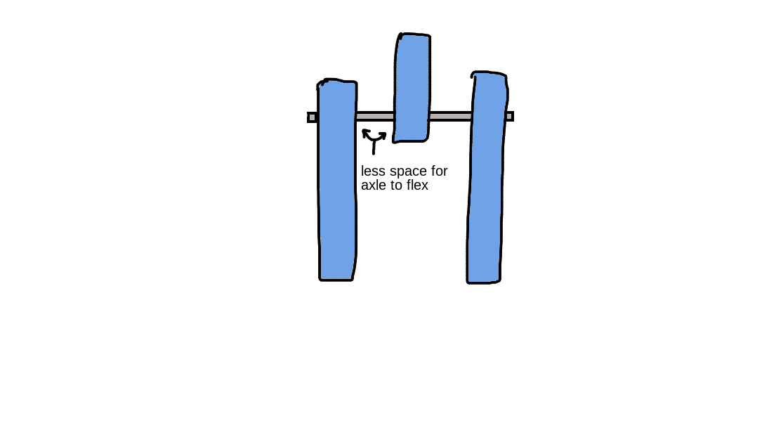

add supports that go to the same height as the original connection where I marked
I think what you mean is to bring the points where the axle intersects with its supporting parts closer together so the axle has less room to flex. Am I right in assuming this?
I also eventually got that and tried building walls on the inside of the drivetrain and fixed it.
