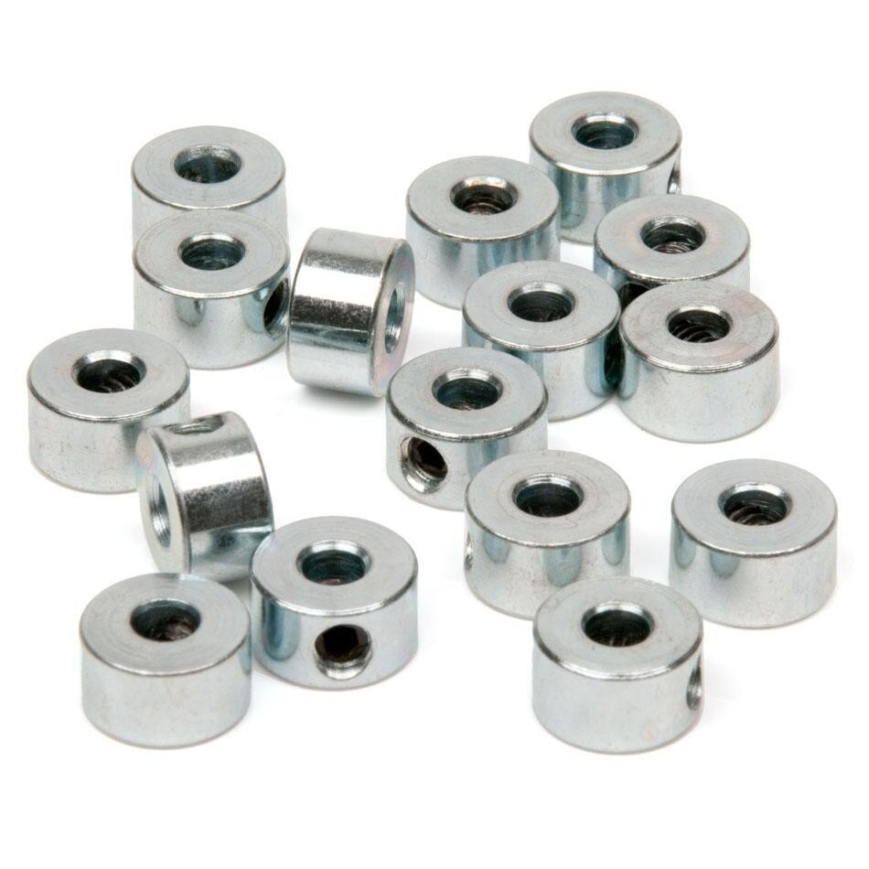

I assume you are using these?
They work fine for Vex IQ, but I would highly recommend using these instead.
(The picture doesn’t show the correct one, but it’s one of the options on that page.)
The square inserts for high strength gears/sprockets fit perfectly in the V5 motors and help to extend the length of the receiver. We have had way fewer problems with slippage since we started using them in our motors.
Those are all VEXPro shaft collars, which will not fit VEX EDR square shafts and are not legal for use in VRC (except in VEXU).
The EDR shaft collar with setscrew is this part:
which is available on this page.
