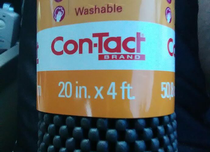

Do you know of any sites that sell legal alternatives for anti slip mat or is vex the only place to buy from?
It’s also sold at stores like Home Depot as drawer liners and router mats.
Watching a few nbn reveal videos might help you with the intake because you can see how different people have built their intakes differently for different setups, but have some general principles in common. Here are some to start you off:
sorry if this seems really trivial but I’ve never handled actual slip mat before
Yes, that’s it. HOWEVER, as you know, it has to be identical to that which VEX supplies. So if you get busted for Home Depot non-slip by an Inspector, you didn’t hear it from me. On the other hand, non-slip is all pretty much the same, and I’ve never heard of an Inspector being upset by non-VEX mat.*
*OK, I did once, when a team showed up with white non-slip mat and the Inspector felt that it had to be gray, like the VEX mat. After discussion with the event partner and head Inspector, they were passed.

thanks for the help, I’ll see when I can pick some up

@Rick TYler
I think I got the right one
