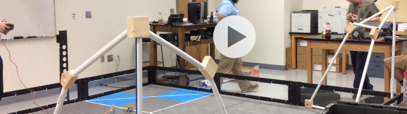

Hey everyone! I just thought I would share this goal that we made for the upcoming NBN competition to practice since we don’t have the real goals to practice with yet. It is made from bamboo, screws and duct tape and is approximately the same size as the real goals. It may be a good low cost option for teams wanting to practice over the summer. Let me know if you all have any questions!

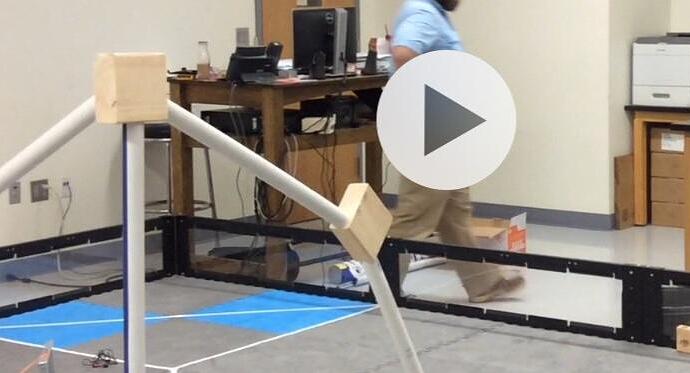

We used some 3/4" PVC and some quality time with the drill press. Where there’s a will, there’s a make-shift high-goal. Now for the netting…ideas?
I think you could use large garbage/leaf bags for the net. It would help keep you from shooting through the goal, and if you pull them tight enough, they should cause the balls to bounce like the actual net.
You might also be able to find large mesh netting at a local store.
You could also use cloth or some old fabric to make a netting.

I guess I should have said that I spent a lot of quality time with Inventor trying to coax it into giving me the dimensions I wanted. Here are the lengths of PVC pipe I used.
117 cm for upright x 1
92 cm for bottom sides x 2
130 cm for bottom front x 1
102 cm for diagonal upright x 2
66 cm for top front x 1
52 cm for top sides x 2
These are not exact, but with the PVC and 2x4 joints it was close enough to work. I did not include the cross bracing because the PVC and 2x4 was strong enough. I don’t expect to be running any competitions with this goal; I just wanted to give my students something to aim for.

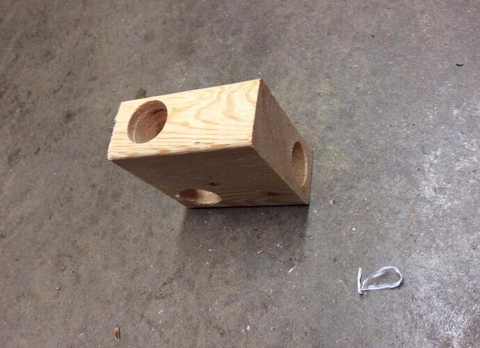

The critical part of our practice goals is the joints that I made out of 2x4 lumber. I cut squares out of the 2x4 and then used the drill press to drill the holes at the correct angles. I used a 1-1/16" diameter Forstner bit to fit snugly over the 3/4" PVC. I have the angles, but I find it hard to put into words how I did it. If anyone needs the angles, let me know and I will try to describe what I did.

Here is a picture of the joint made out of 2 x 4. This is the simple one. The others were much more complicated and I would never do it this way without access to a drill press that can drill on angle in two planes at the same time.
