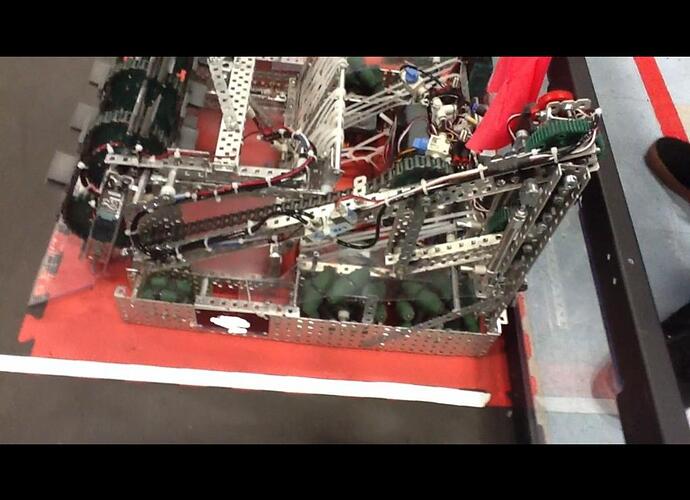

Hey everyone! May someone explain to me how this bar design works? Is it a 4 bar or is it technically a 3 bar? And if someone has any ideas on how to use it for Toss Up that would be much appreciated

That would be a chain bar with a tilting sprocket ratio and pneumatic assist. Hmm looks familiarâŚ

Now Aaron could you explain to me how the chain and sprocket idea actually works? Iâve seen the articles on the Aura website about them but I donât fully understand how that is efficientâŚIt just seems like it creates more stress on the chain I do see the pneumatic piston in the back but does that âLâ shabed elbow give it support like a regular bar design lift?

And clabrador96 the chain bar is basically one sprocket at the tower that does not pivot attached to another sprocket at the end of the bar which does pivot. Iâm not sure if I explained right.
Jesse323Z has a nice tutorial explaining the concept.

What do you mean by âefficientâ? And âmore stress on the chainâ compared to what?
Every different mechanism has its advantages and disadvantages. A chain linkage can rotate further than a 4-bar in many applications. (example - see how the arm goes completely vertical?). And if you want your intake to tilt while you lift (always by the same amount) then a chain linkage allows you to do this using different sprocket sizes, similar to using an unequal 4-bar, but different tilting geometry and rates.
I donât like chain linkages where you have something reasonably heavy on the end of the arm, or where you need very precise movement, I prefer 4-bar linkages in those situations.

yeah the â4 barâ looking part of the arm is just a way to have all four motors power the top two bars and is convenient for pneumatic assist.
Yes we did experience some issues early on with precision, especially when scoring on the high goal. Due to the chain the basket had some âslopâ in it, meaning it would rotate a bit back and forth around the pivot point. We found that you can remove a lot of the slop by using lock bearings on the sprockets.

Sorry I was comparing it to a 4 bar or a 6 bar but looking at the design now it looks better than a 4 bar or 6 bar idea but whatâs cool about it is that incorporaties the 4 bar âmechanicsâ while at the same time it uses pneumatics and the chain and sprocket lift
You guys definitely helped thanks again to Chris at *Aura and Aaron whose team originally created the fantastic robot
