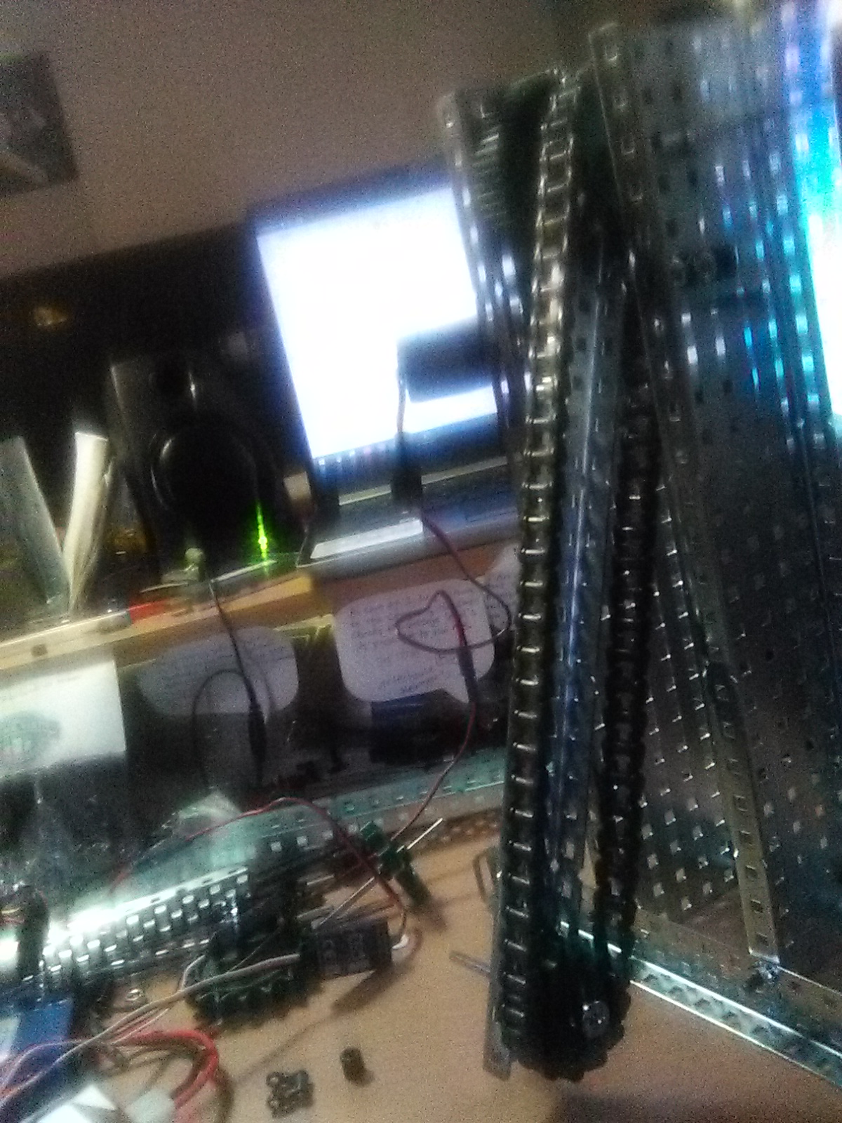

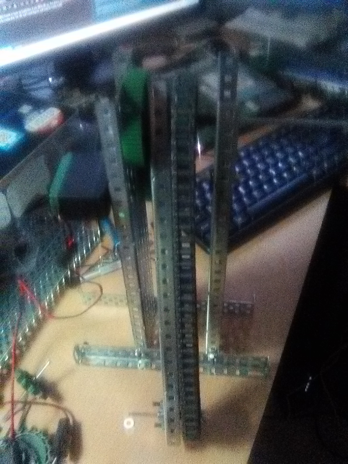

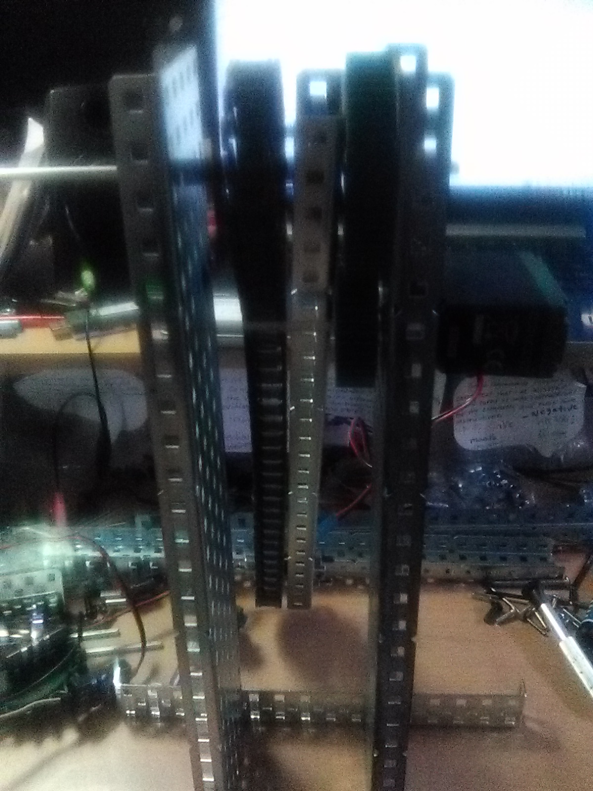

Please, All i want to know is how do I get this 1 bar lift to lift up. Are there any tutorials? People have shown me how to make the bar lift, but I cant figure out how to make it lift. I can’t believe I build the Clawbot from the VEX Guide for Builing the Clawbot booklet, but can’t get this bar to lift. Any suggestions?
Is everything else working as expected? Why can’t it lift? Does the motor turn on but not have enough torque to lift it? Or does the motor not turn on at all? Is the motor on and the lift is not moving at all? There are many, many reasons why this could not be working - anything from a bad motor, bad wiring, bad programming, unengaged axle, reversed motor. The symptoms and the “why” of why it’s not working should give you some troubleshooting hints.
What do you mean by torque? The motor turns on, the lift moves a little. The motors are brand new. I even open a new box a replaced it but it just won’t lift. I don’t get it. The wiring are all brand knew out of the box. I was told that it’s not the programming. Don’t know what unengaged axle mean, I will google it. Thanks for responding back. Below is the video link and some pictures.

Take out the axle from the motor and try to move the arm. If you struggle to do so, then there’s friction somewhere that needs to be removed. Take spacing into account when building the lift. I’d also look into using aluminum; steel is heavy and hard to move. Finally, check gear ratio, both in the motor and in your arm. Try changing the motors to be geared for torque, and change the gear ratio from 5:3 to 7:1 on the arm.
Unengaged axle just means that the axle is not fully seated in the motor.
Like the PP said, it sounds like you have too much friction and that is causing the motor to stall. If you reduce friction and still have trouble, you may need to increase your gear ratio.

Move the lift by hand and see if it’s going up. If it isn’t, the lift is catching on something.
Either the arm or the large gear isn’t engaged with the axle (I couldn’t tell if the top axle was spinning from the video). If they were, the motor would not be able to spin without the arm moving. Make sure the arm is actually connected to the output of the motor in some way. Usually people bolt an arm to the driven gear through the screw holes in it.
I might be wrong, but it looks to me like you may have bolted the top gear to the arm and the steel tower. Is that the case?

That lift in the second video is a chain bar. Its purpose is to keep the object at the end of the bar at the same orientation at all times. The sprocket and the bigger gear both have circular inserts. The sprocket is screwed into the side of the tower. The bigger gear is attached to the channel that is being lifted. You need a gear ratio to get the lift to move.

Yes, I see it. The motor axle is spinning freely. YouTube should have lots of videos on chain bars. Perhaps look some up.
Gear ratio refers to the size of your output gear over your input gear. Currently, your arm has a 5:3 gear ratio, because your 36 tooth gear is spinning a 60 tooth gear. This means that your arm will have 5/3 the torque output of the motor. When @64540A suggested you change your gear ratio to 7:1, he meant replacing the 60 tooth gear with an 84 tooth gear, and the 36 tooth gear with a 12 tooth gear. This would change the torque output to 7 times that of the motor.
If the build hasn’t changed since the last post, I think you may have built the lift incorrectly.
The top gear should have square inserts.
The top gear should be bolted to the arm.
The sprocket on the motor axle should be drilled out so the axle can freely spin inside it.
The sprocket on the motor axle also needs to be bolted to the tower.
