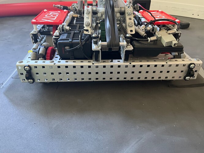

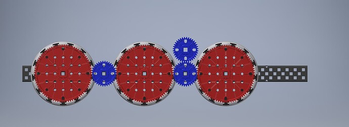

Hello, I had a problem when testing my robot’s ability to climb the barrier. We have been using the gear ratio 36:84 with 4 motors (shown below) and the amount of spacing in between the gears was the perfect length for it to get stuck climbing the barrier. I wanted to know if there was a better orientation that minimized the amount of space between each gear, or if there is a better solution (new gear ratio, wings, elevated surface, etc.) Thanks!

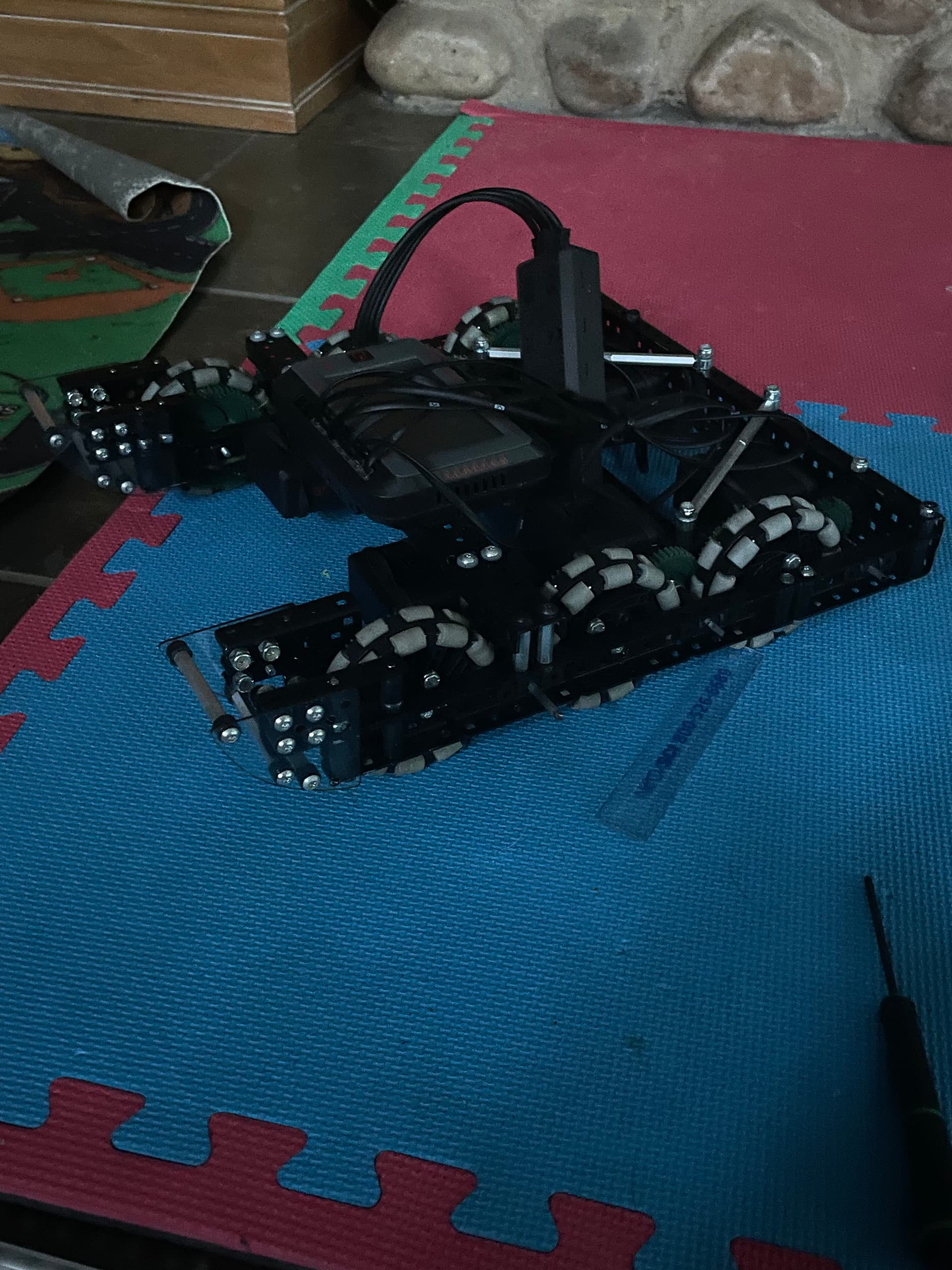

This season, a lot of teams are using sleds. It’s pretty much an addition to the end of your drive that allows for the drive to go over the barrier much easier.
But there are tons of designs for this, I’d recommend looking into some robots online and picking one that would fit your robot. There are a LOT of videos on youtube too.
I’ve attatched some pictures of different designs that teams are using below.

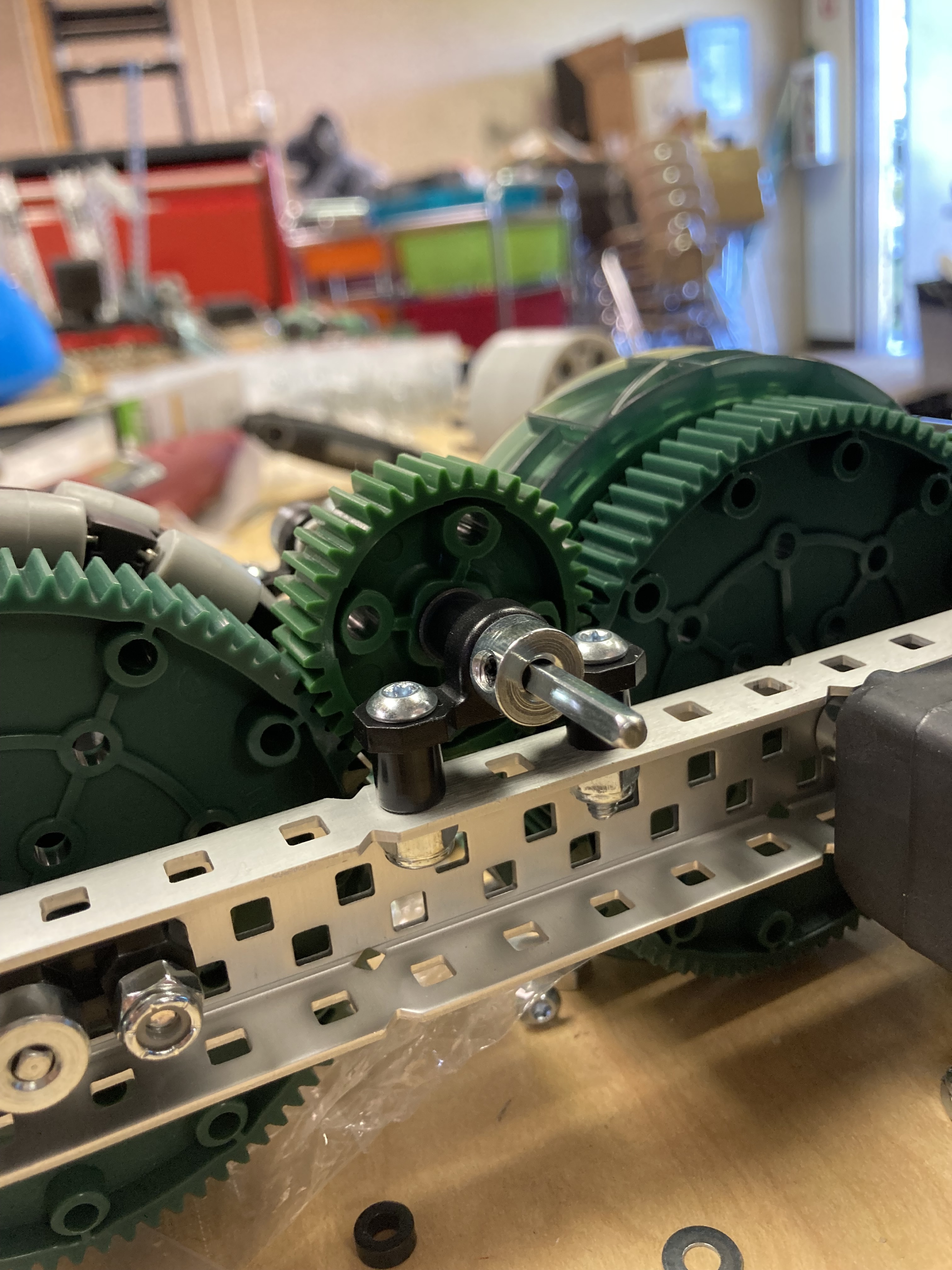

You could do a quick proof of concept by extending the c-channels to fill the gaps - essentially add another c-channel to your frame below the existing one. See if it works.
64feeb4d1a154197b5429ae68da8fe6d645a3cf9
We used a similar gear ratio, but offset the gear s to to minimize gap, hope this helps.

Our team used a sled-like structure below the drive to get rid of the gap.
