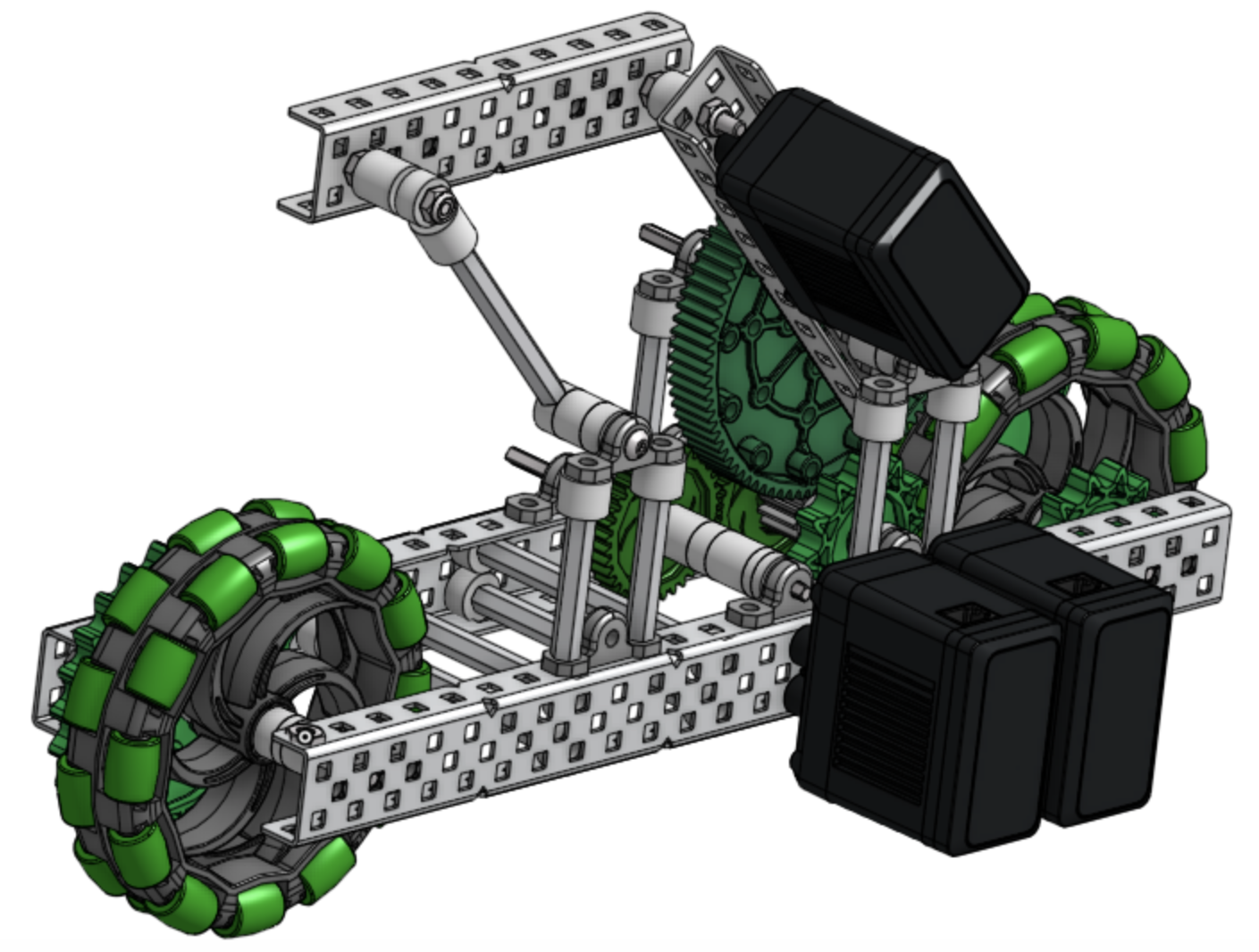

Here is an experimental drivetrain I finished cadding today, its meant to run at either 240 or 250 rpm on 4" wheels32 PM

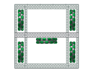

H drives are normal omni wheel tank drives but with a 5th motor powering a wheel perpendicular to the front to allow for sideways motion:
