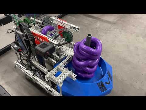

If you have 5 days until comp, I would recommend making sure you have few good autons , skills paths, and lots of driver practice. If you are dead set on scoring rings or already have the aforementioned things, then I would check out my team’s hook conveyor. It is decently fast, uses 1 motor, and relatively simple.
Early season prototype:
In action:

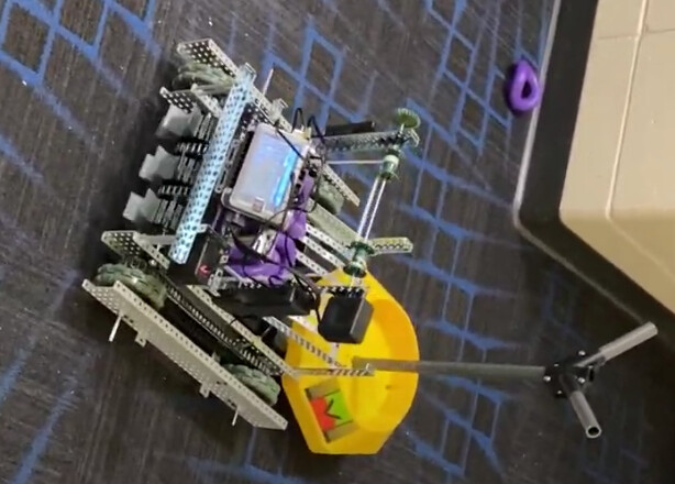

I believe I have a solution for you. Today was my school’s “debut” in the world of VEX, so I will give you a picture of the robot we competed with.
We’ve made some small modifications since this picture was taken. We obtained permission to test the robot while viewing an event, and now today was our first competition. Outside of that, we only had 2 rings and no mobile goals or field to test our robot with. We placed 15 out of 23, winning our first elimination match (and losing the second). Overall reliable for not having tested it. Simple concept, somewhat easy build, with slight tweaking.
If you would like more details, specs, or have questions, please DM me. I would be happy to share!
