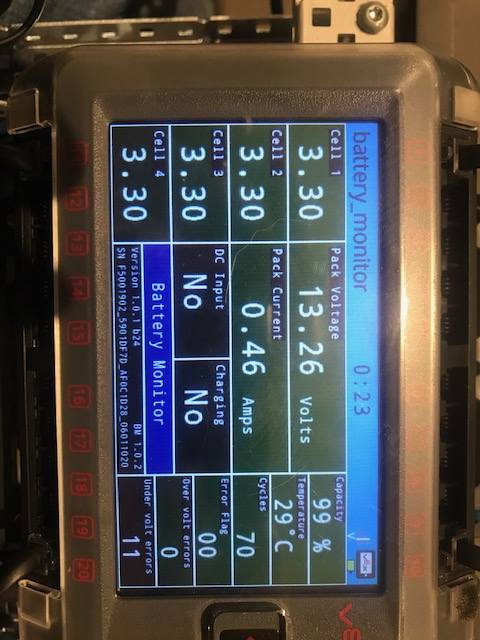

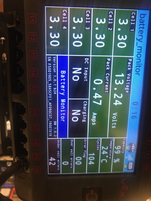

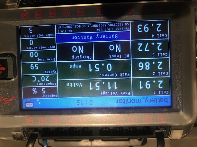

We charged 3 of the batteries up to full capacity, and then ran the battery medic on them. All of our firmware was up to date prior to doing this. As you can see from the pictures, all 4 of the cells have equal power. The only thing that we can see is that they all have multiple “under volt errors”. What are these? and can that be what is causing our issue?
We also paid attention to these batteries while charging, and they all went from 1-2 green lights on to 4 blinking lights when fully charged. We have not ran all 3 batteries yet, but the one battery that we did went from 4 green lights to 2 green lights after a normal 1:45 match run time. There was hardly any load on the battery while running. only 4 motors driving 4 wheels in a holonomic set up 200rpm.
the 4th battery in the picture we did not have time to charge, but it looks fine as well.
any ideas on why the batteries are not holding a charge would be appreciated! Again, thanks for everyone’s help!
Run the medic with a battery connected to the V5 and also on charge, make sure the full charge voltage is somewhere near 14.4V and all cell voltages are up near 3.6V. Run the battery on the robot until the V5 shuts off, check the battery with the medic again and make sure none of the cells are less than 2.5V. When you are driving, have a look at the battery dashboard and note the typical current, I would expect a 4 motor holonomic drive to be using less than perhaps 6A and should last for 15 minutes of driving.
