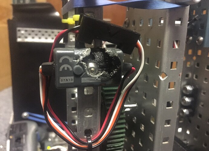

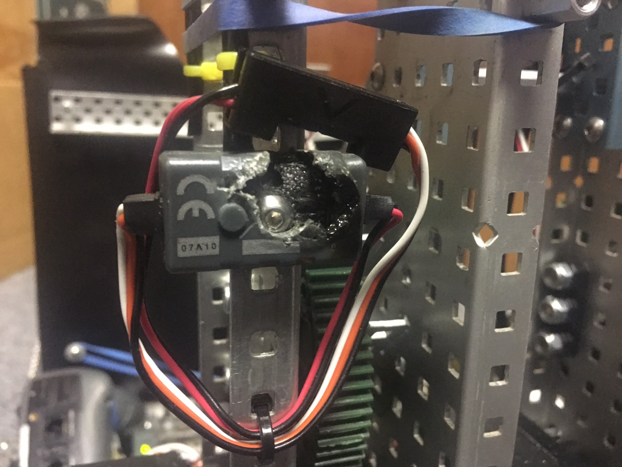

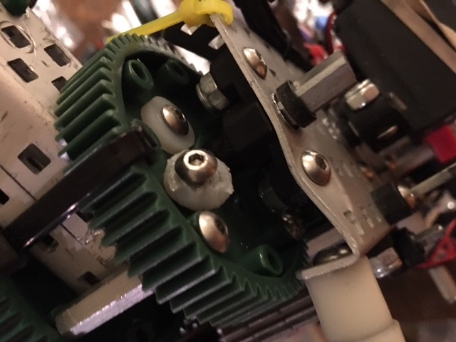

It may well be friction as well. You never know until you take a look. My middle schoolers played through losing in the finals this past weekend with this. That screw with the 1/8" spacer was bent to about 75-90 degrees
