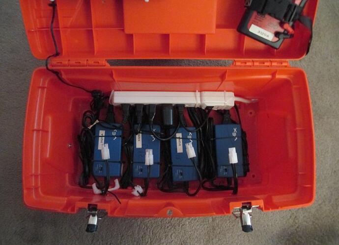

A couple of years back, we saw that a team (unfortunately I don’t remember which team) made a post about a box they had built to manage their batteries. Inspired by that post, we built our own version. Ours is built from a plastic “Homer Box” from Home Depot - I think it cost $9.00. Here’s the description.

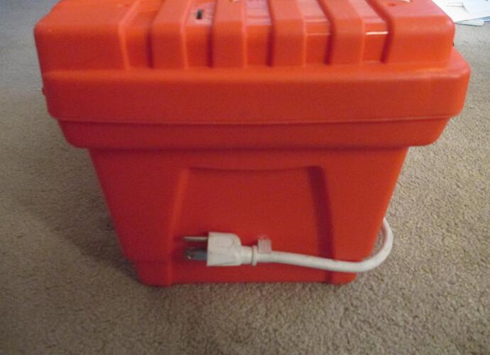

There are four battery chargers zip tied to the bottom of the box. They are all plugged into a power strip. I cut hole in the back bottom of the box to bring the plug from the power strip out.

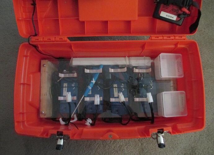

Over the chargers, I built a simple shelf out of a piece of polycarbonate attached to two blocks of wood. The shelf is clear, so we can see the light on each charger.

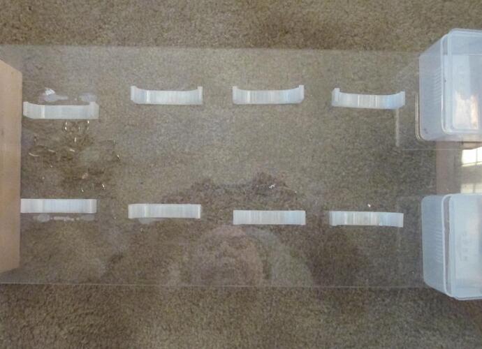

On the shelf, my son built some 3D printed battery holder grippers. Also on the shelf are two small plastic boxes for AA batteries (attached with velcro). One is labelled “Charged” the other is labelled “To Be Charged”.

Finally, on the outside of the box, my son created a 3D printed cable holder, so the plug can be attached to the box for transportation.
Our team has found this a great way to manage our batteries. The portability of the battery box makes it perfect to transport between meetings and competitions.
I hope other teams might find this design useful.

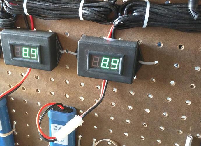

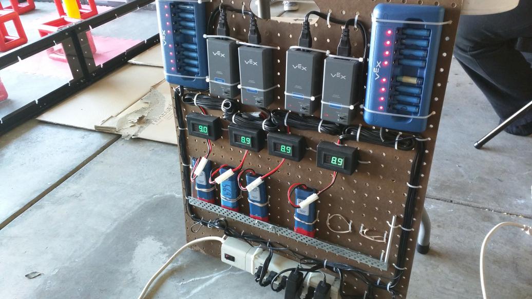

Here are a few pictures of our battery board. The voltage meters read a little high because of the incoming current, but at least we know they are charged ~ 8.9V
Where can I buy those voltmeters?
You can get an inexpensive volt meter at almost any hardware or home store. I like the ones from Harbor Freight
http://www.harborfreight.com/7-function-multimeter-98025.html
Presently on sale for $5.99. I like them because if they get broken, lost, stolen, etc. I’m not as upset as if it was my Fluke meter.

The person at our school who built our battery board is on vacation, so i can’s tell you the exact one we used. That said, something like this: http://www.adafruit.com/products/575?gclid=CjwKEAiA5qOlBRDAn8K5qen65joSJADRvlbq17mwUqXoleuTulqctO3DWOGmm1ii5_12-Y4W0sVCoBoC9arw_wcB looks very similar.
