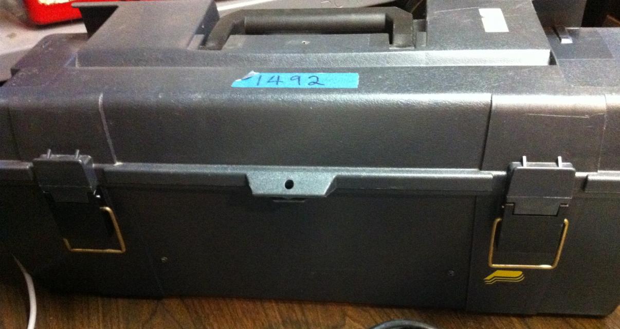

We just got an empty toolbox and velcro-ed a power strip and our 4 battery chargers to the inside. A larger hole in one of the corners of the toolbox lets us plug the power strip into another outlet with the power strip’s extension cord, powering all of the chargers. Above them is a removable polycarbonate shelf. The charger cords loop through holes in the shelf which keeps the cords tidy. We can just drop empty batteries on top of the polycarbonate shelf and plug them in. On top of that is another removable shelf that holds batteries waiting to be charged as well as fully charged batteries.
Bit of a chaotic response, but I hope you get the picture. There are lots of ways to make an efficient battery box, and it makes battery management much easier.

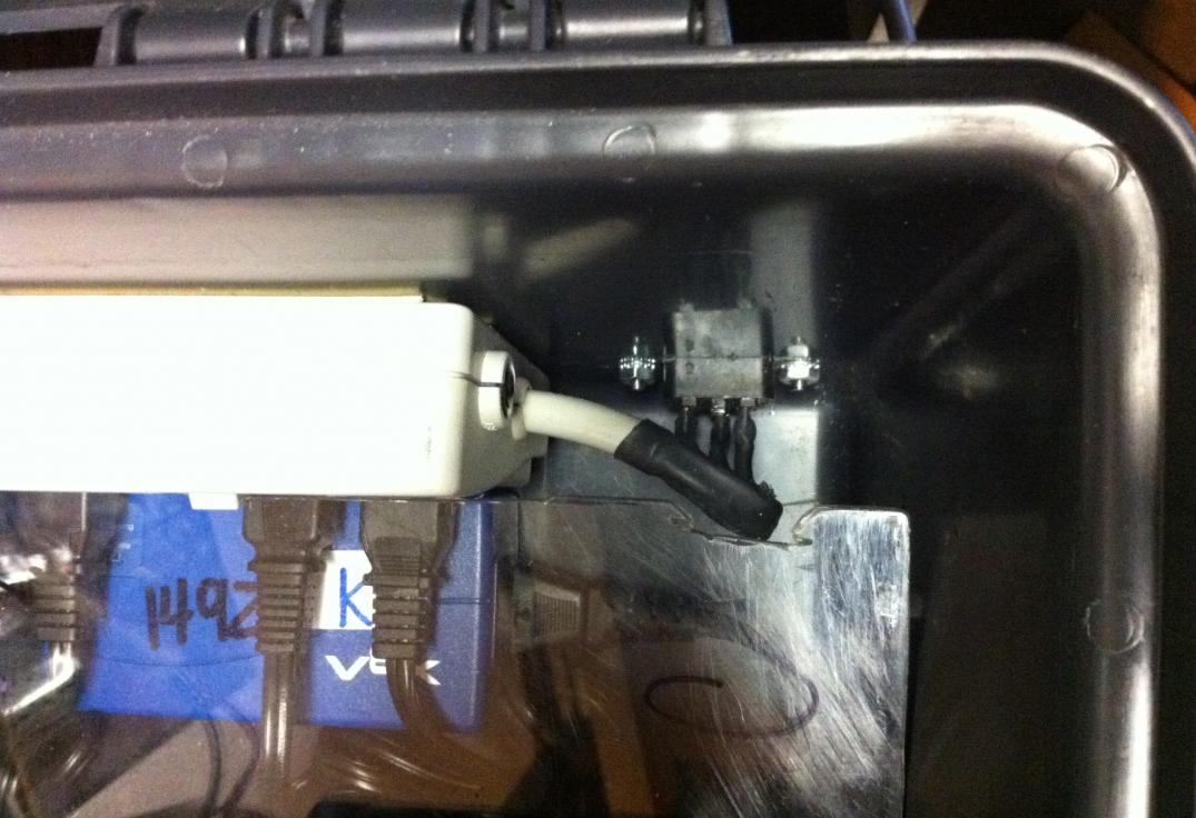

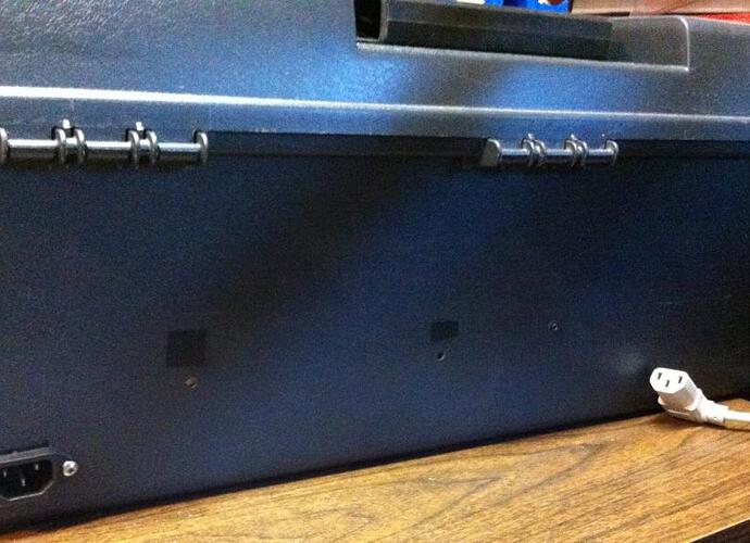

The cord on the power strip was cut off, and the 3 individual wires inside were soldered to the socket, which is attached to the back of the box. The socket came from an old PSU, so we simply use a power cord between the box and the outlet.

thank you all for your imput. Looks like I will be going with the tool box model like 1492. Seems very efficient and handy. Thanks again for everyone help.
