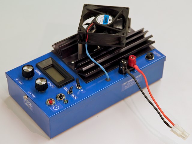

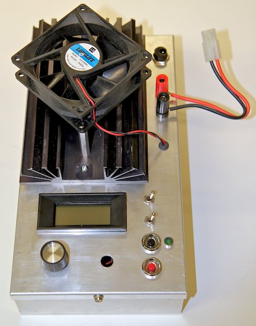

OK, the dummy load is finished. Well, v0.1 is finished :wink:
This project is made primarily from junk box parts and is based on this schematic, but with a few upgrades:
[INDENT][LIST=1]
*]An LCD panel meter to monitor Volts & Amps
*]A fan to keep air flowing over the heatsink
*]Regulated 5V and 12V power to run these upgrades
*]Input for a DC wall wart to run the regulators
[/LIST][/INDENT]
[ATTACH]3337[/ATTACH]
OK, a quick walk through the controls:
The knob on the lower left corner sets the current load. This is a 10-turn control, so each CW turn increases the load by about 2A.
The hole next to the Amps knob is for a voltage limit knob to disable the load below a set voltage. Not yet implemented.
The black and red buttons will enabled and disable the load. The LED by the black button tells you when the load is enabled. Not yet implemented.
The LCD is a 3½ digit meter to monitor the current load or voltage. The top toggle switch by the meter switches between V and A.
The bottom switch by the meter lets you select between monitoring the actual V/A or seeing the V/A setpoints. Not yet implemented.
It seems to work very well, and works all the way down to about 0.6V. I haven’t yet let it run full-power to see how hot it gets - I think I’ll work up to that. I did let it draw a full 20A load from a Vex NiCd pack for a short while. The pack voltage fell to about 1.2V and the wires got hot, so I didn’t keep that going for long :wink:

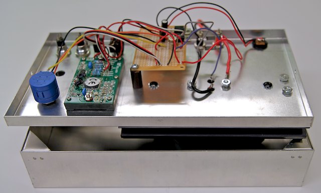

As for the insides - this was a pretty quick job. I’ve got room on the protoboard for a CMOS chip or two to implement the voltage limiter.

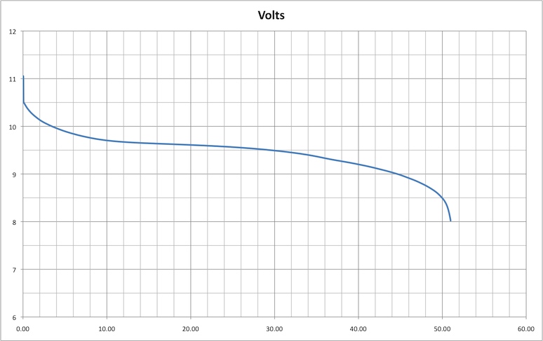

Here is the discharge curve from my first test run. This was taken using an integrating power meter with one sample every second.
The battery under test is a 9.6V NiCd transmitter pack (1000mAh) and the test load is a continuous 1A. The battery is fairly old and has not been specially cared for. It was fully charged using the new Smart Battery Charger in “Safe” mode, and then allowed to rest for about 10 min to cool to room temperature.
[ATTACH]3343[/ATTACH]
You can see the voltage starts at about 11V (about 1.4V/cell), which immediately falls to about 10.5V when the 1A load is applied. Calculations suggest the internal resistance of this battery is about 0.543Ω.
The discharge graph is a perfect textbook curve, with the battery discharging to 8.5V right at the 50 minute mark. (8.5V is the point that the transmitter starts beeping). Exact measurements show this battery produced about 836mAh, or 84% or its original design capacity. This seems reasonable for a battery of this age and condition.
You can see that the voltage falls off rapidly after 8.5V, as you would expect from a depleted battery.
Also, note that the midpoint of the discharge (25 min) shows 9.6V, which is the rated voltage for the battery pack.
This all tells me my approach to battery analysis seems to hold up to some data. Over the next few evenings, I’ll run the full line of Vex batteries under increasing loads until I get a good set of graphs, or until the dummy load burns out ;).
Cheers,

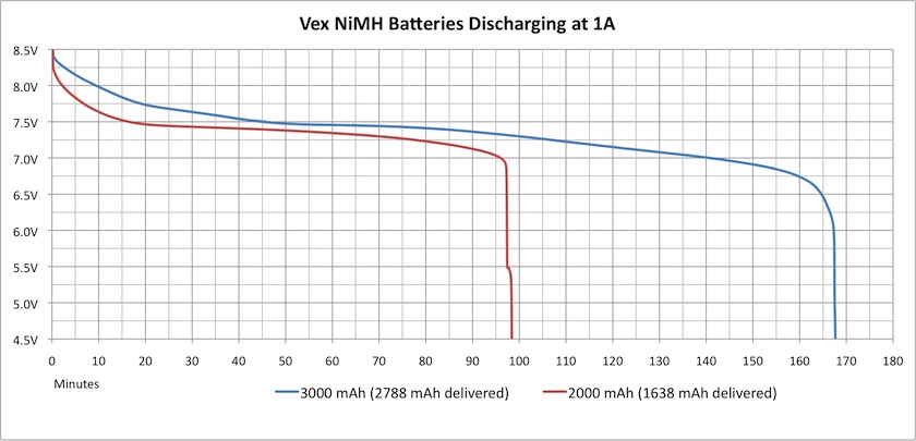

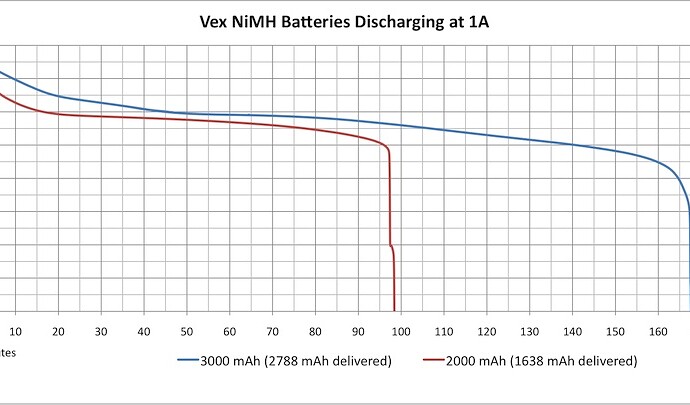

Here is a graph of the new NiMH batteries being discharged at 1A. Note that these each represent a single run of a single battery, so this is more anecdotal than statistically sound data.
I’m posting this quickly since folks seem interested, but I do plan to post more complete data up on the wiki after I’ve collected everything.
[ATTACH]3346[/ATTACH]
They have a wicked-steep voltage falloff at the end of the discharge. It can drop from a sensible voltage down to the danger zone (below 5V) in a matter of seconds. This means I need to get the voltage limiter circuit working before I attempt the higher-current runs.
You may notice that they don’t deliver their rated capacity, but that is expected. The internal resistance of any battery makes it impossible to extract the full charge. According to Wikipedia, NiMH batteries are usually rated assuming a 0.2C discharge rate, which would be 0.4A for the 2000 mAh pack and 0.6A for the 3000 mAh pack. Since I’m discharging them at 1.0A here, I would not expect to get the full rating, and the effect will get worse as the current load goes up.
Cheers,
Nice work Dean.
Even at just 1A, the 3AH (new large) battery shows smaller internal resistance and a higher voltage than the 2AH (new small) battery, as expected.
Try not to burn down the house as you crank up the load current.
Yep - it’s nice when theoretical and experimental results line up.
BTW, I’ve calculated the internal resistance as 0.109Ω for the 3000mAh battery, and 0.264Ω for the 2000mAh battery. I’m sure those numbers are off by a bit (±10%?), but they should serve as a ballpark figure for those that care.

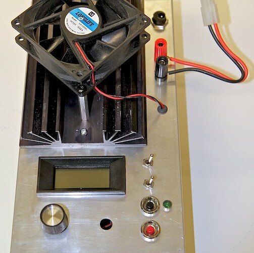

OK, I got the voltage cutoff implemented, and upgraded a few other parts that were a bit iffy. Everything seems to be working well now.
I tried it out up to 8 amps and the transistor gets hot, but not too hot to touch, so I think I’m ready to go now. I’ll save the 12A runs till after I’ve finished the 8A runs, just in case :wink:
I also powder-coated it a nice “Vex battery” blue:
[ATTACH]3397[/ATTACH]
I’ll post results as I get them; probably a run or two each evening this week.
