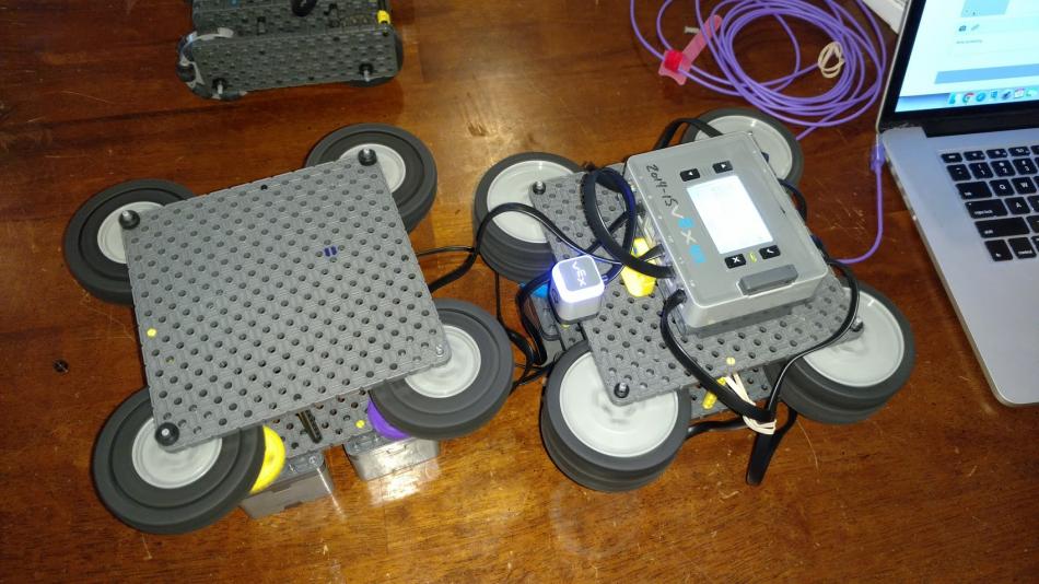

Good suggestion Bez. I’m working on something similar to that. A 4 motor drivetrain is setup as a test harness. Modkit is able to return the battery voltage (I don’t see a way of getting the voltage in Robot C or Blockly/Python). The Modkit program reports the initial voltage before starting the motors, the voltage 3 seconds after the motors start, and then how long it takes for the voltage to drop below 7 volts.
There is a clear difference between a new battery and a really old one, but I still need to tweak the numbers. It may not be necessary to run the battery down to 7v. So far the 3 second mark has been a good indicator.

Keep in mind that the whole reason for this test was to weed out batteries that were not up to par. All of the batteries that I have can get a full charge and show 100% charged in System Info. However, they are not all equal. Although they are all fine for practice and small robots that don’t require a lot of power; later in the season, when the robots get bigger, and the auton routines get longer, you are going to want to make sure that you are using a ‘good’ battery.
The 4 motor drivetrain was a good test harness for stressing batteries, but it wasn’t something that could be easily repeated by anyone else, or even myself at a later date. So I setup a flywheel tester. The initial version had 4 motors each with two big tires spinning on a 3:1 gear ratio. That didn’t stress the battery as much as the 4 motor drivetrain, so I went to 8 motors, which was better, but still not draining the battery as fast as the drivetrain. More on setting up a good test later…

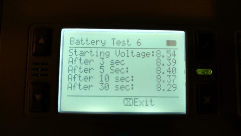

The test checked the battery voltage before starting the motors, and then at 3, 5, 10, and 30 seconds. All batteries were charged overnight before being tested. Looking at the test results it is easy to predict which batteries are going to hold a better charge within the first 10 seconds. In some of the earlier tests I kept it going for a couple minutes, but that extra time doesn’t really provide any meaningful data. Testing that the motors are maintaining a consistent speed (as suggested by calvc01) is worth considering; not wise to assume it is proportional to the battery voltage.
Here are the results for the 40+ batteries that I tested.
https://docs.google.com/spreadsheets…it?usp=sharing
Note that the voltage always takes an initial drop and then bounces around for a couple seconds before stabilizing. One other thing worth noting is that the voltage bounces back once you take the load off. So if you look at System Info after the test, almost all of the batteries that I tested would say 100%.
These results are good enough for me to decide which batteries shouldn’t be assign to teams this year. I’ve decided to draw the line at 8.05 volts after 30 seconds. Any sub-par batteries will be marked and kept as spares.
