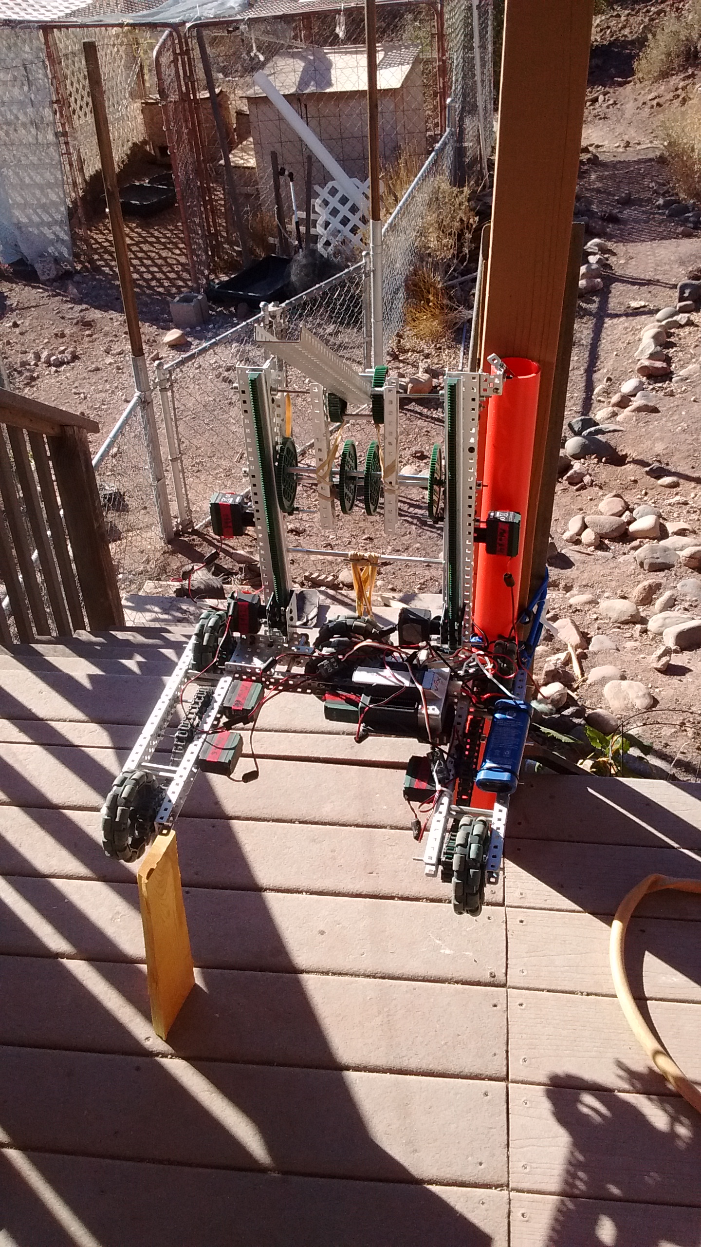

The first picture is our first iteration of our robot, with a 5 motor H drive, 2 motor choo-choo catapult, and 2 motor high hang. This was during the summer, around the middle of June. It does not have an intake of any sort, more of a proof of concept for the catapult. The robot is shown hanging over a shard of 1"x12" wood, with the top and the bottom both being factory edge. Incidentally, 1"x12" is actually only 11 and 1/4 inches, so that’s not a full high hang on most fields, although we do have quite a bit of clearance, so I guess I’ll never know if that bot could actually high hang.
