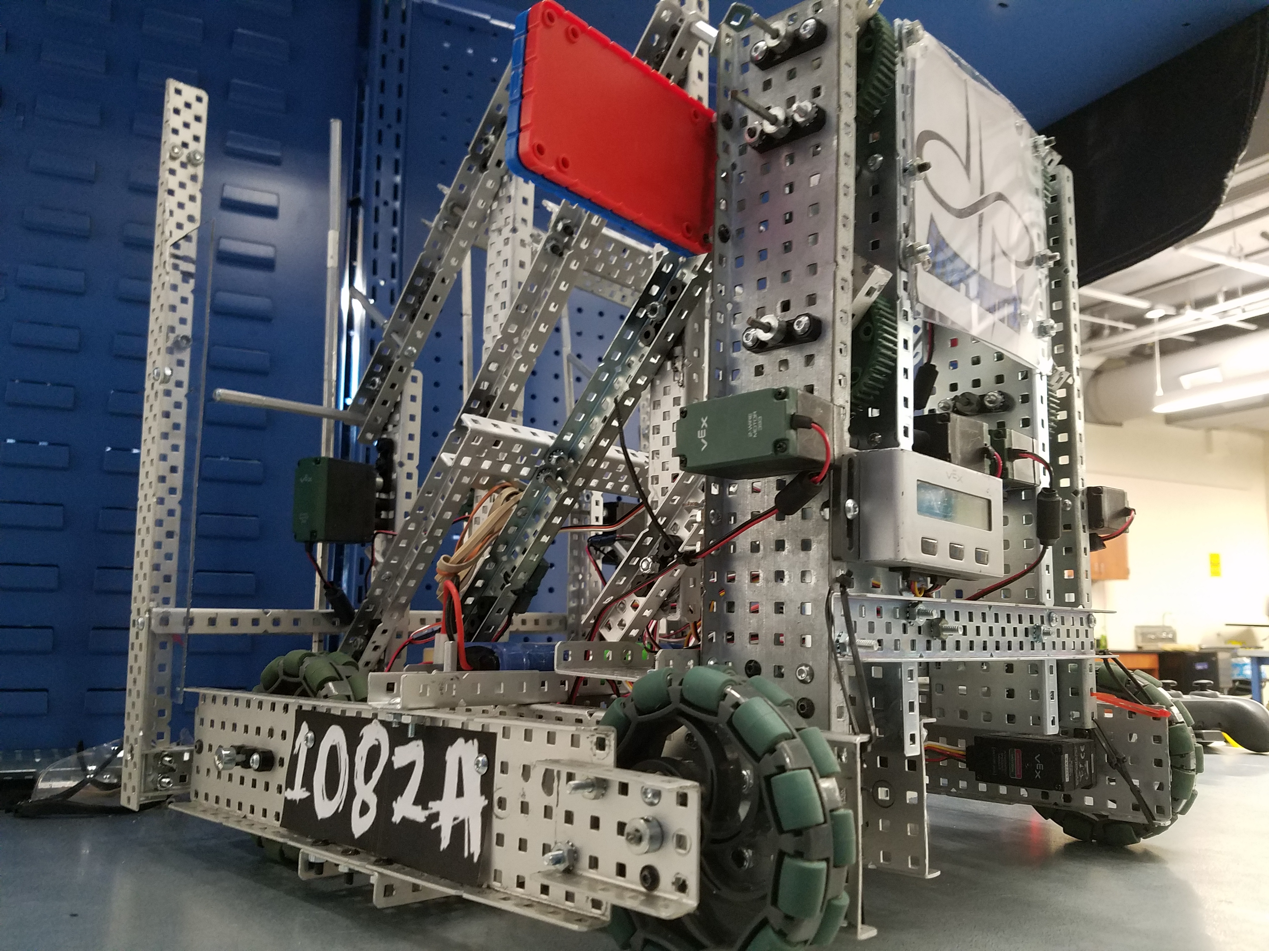

My team have a reverse dumper using two turntables to power it. The intake for objects it a 7 prong fork made of standoffs. We were thinking about a claw at the end of the arm but we didn’t like how heavy it made the arm (at the time we had a limited amount of motors, only a total of two for the dumping arm) and because of that we made a pneumatic claw that attaches too the base. It allowed us to clamp around objects, pull them to the fence, open the claw and then dump them over. And the claw didn’t move with the arm. So far it was worked pretty good although we are working on a couple of issues.
The picture is from when the claw was motor powered and the prongs were axles but it’s the same idea. We found that a motor power claw is only good if the gears are physically synced, otherwise one of the claw arms could get caught and they won’t be aligned anymore. That’s why we switched to pneumatics
