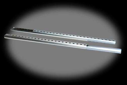

When building anti tips, make sure that not a lot of your robot’s weight is being put on them, or they might bend (happened to us). Honestly, I would say that linear slides are the best as you can house them inside your robot.
The old, discontinued linear slides are really really good. Sucks they got discontinued because, in my opinion, they are better than the slides VEX produces nowadays.
I use a linear slide with a metal guide at the rear of the robot, it is really effective
Vex used to make different linear slides?
Yes, they were both made out of metal, so if you add just grease you’ve got yourself a nice, robust, and sturdy mechanism to use. Quite sad they turned to plastic for their designs and discontinued this nice product:
thang
Is there any way to buy these sliders now? Obviously not with vex but maybe on another website?

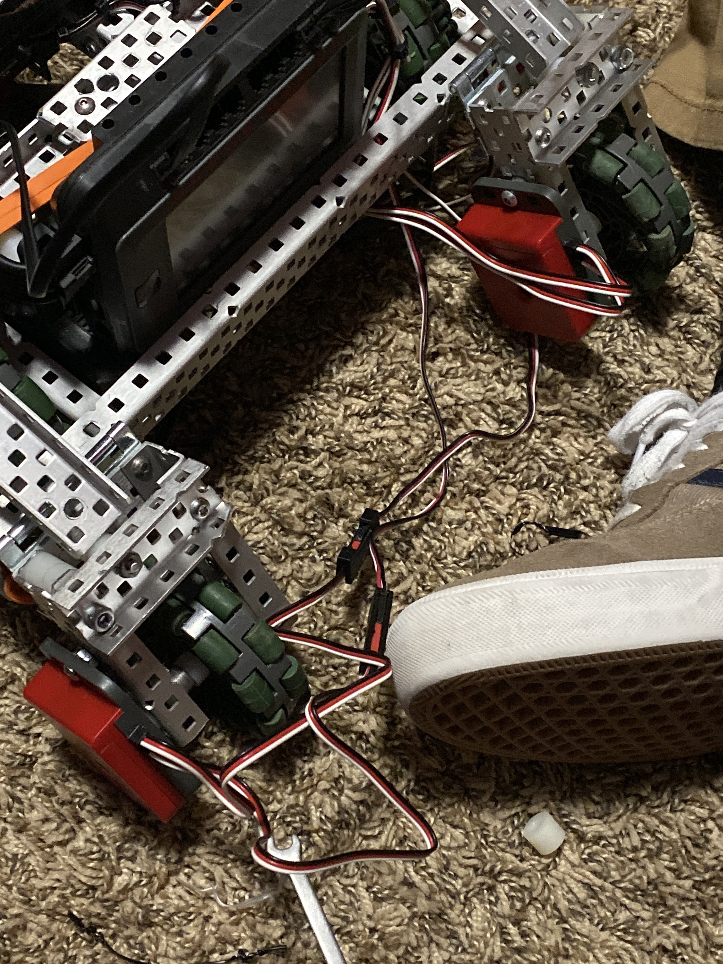

How do these flip down and lock? They are very cool
The wheel assembly flips down on a hinge, and a c-channel locks the assembly down from the top.

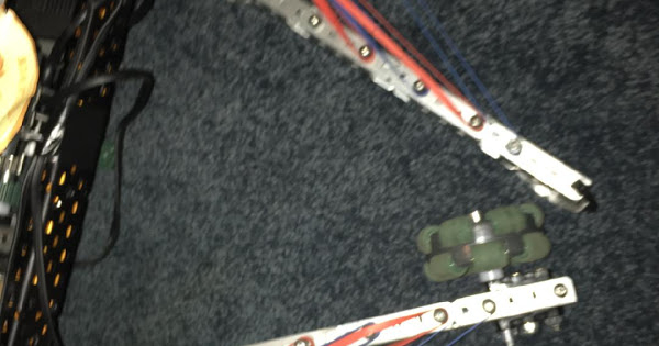

we have found that using a tri pod style anti tip, it seems to work better for us than traditional anti tips.
You posted the same image twice
where do you get the small omni wheels?
from vex’s website. https://www.vexrobotics.com/edr-wheels.html
they are 2.75 omnis.
