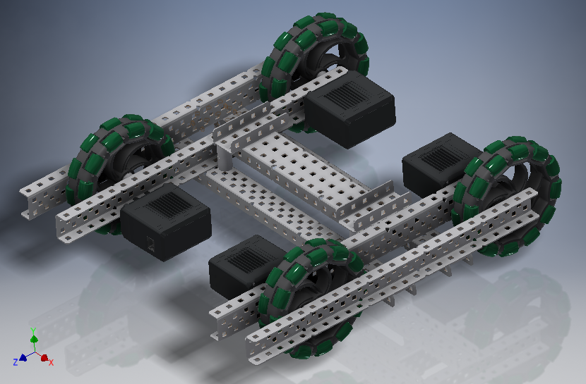

no problem! I didn’t make it, I got it from @Sylvie who got it from somewhere else. but I use it all the time to do things like this, only taking an hour or so.
Chassis%20One%20Pic
