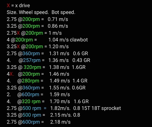

The chart i use for drive speeds
If theres a better resource hook me up
This information seems inaccurate. 200rpm X drive is slightly faster than 280rpm.

what is GR in the table
I believe it is the gear ratio of the drive
Gear ratio
