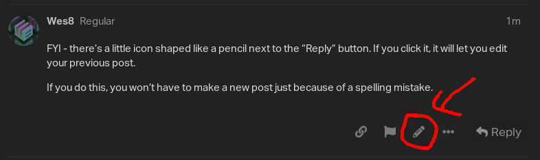

@RoboDawg6463 FYI - there’s a little icon shaped like a pencil next to the “Reply” button. If you click it, it will let you edit your previous post.
If you do this, you won’t have to make a new post just because of a spelling mistake.
Edit: It’s this one:
