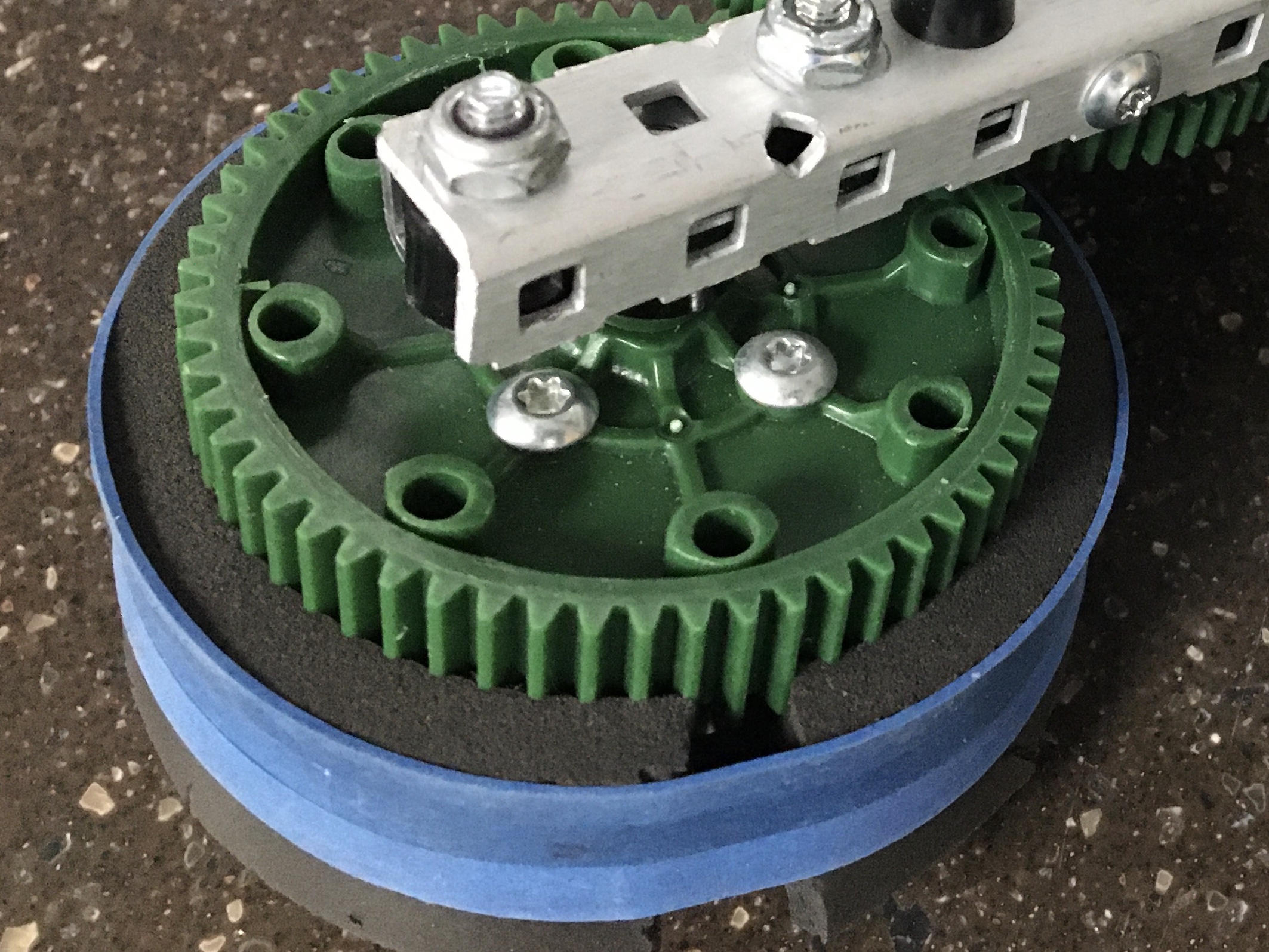

I have kind of got this to work before, This wasn’t my idea but the way I would do it is by using anti slip mat around the outside edge of a 84T high strength gear, then putting rubber bands around that. As seen in this image (black is anti slip mat, green is HS gear and the yellow is the bands). compliance

Currently we are using a couple high strength gears wrapped in foam and rubber bands. This has proven to be a very viable and effective “compliance” wheel design. Out of the intakes I have personally seen tested and during matches throughout competition, it has been the best intake design. I have not been able to see an actual VexPro compliance wheel intake yet.
These are our current intakes, and so far we have seen them perform better than both flaps and omni wheels and throughout the many months we’ve had them, we have had little to no trouble with them.

We have done this, but the friction mat is very easy to compress, and will remain compressed if held down for extended amount of time. Even with 4 layers of thick friction mat only a few rubber bands were able to completely compress it, at which point the mat becomes basically pointless and deforms.

Have you tried adding another layer of foam? Not sure how much more compliant that’d be, but I think it’s worth testing.
Another custom option could be rubber links with standoffs for spokes and a polycarbonate ring wrapped in foam.
