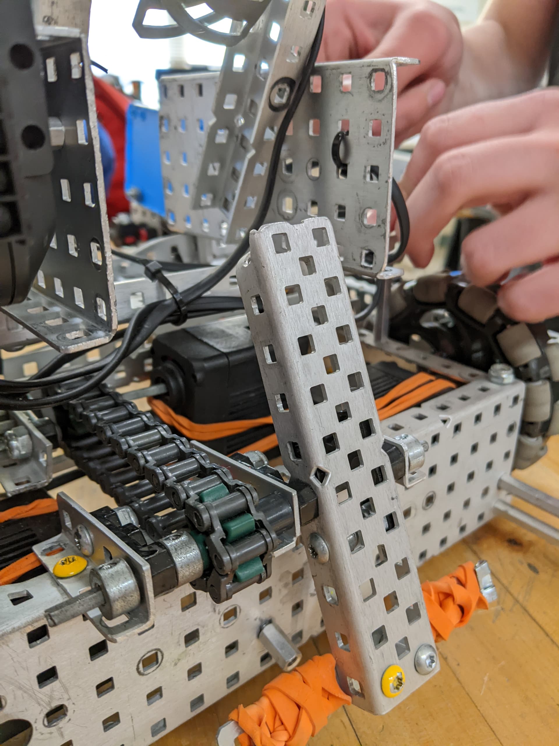

I would highly recommend using a motor attached to a chain connected to a t-shaped mechanism. This is what our team utilizes and it is SUPER consistent and strong. I’ll see if I can take a picture of it at practice today to show you.
To build off, the exact design is similar to a c channel on a hinge, which is then powering in the back side via a piston. This allows the clamp to rotate, clamping a goal. One tip I would give is to use plastic and “mold” the shape of a goal on your robot, so when the goal goes to get clamped by your robot, the plastic rollers turn the goal so the clamp clamps it at one angle only.

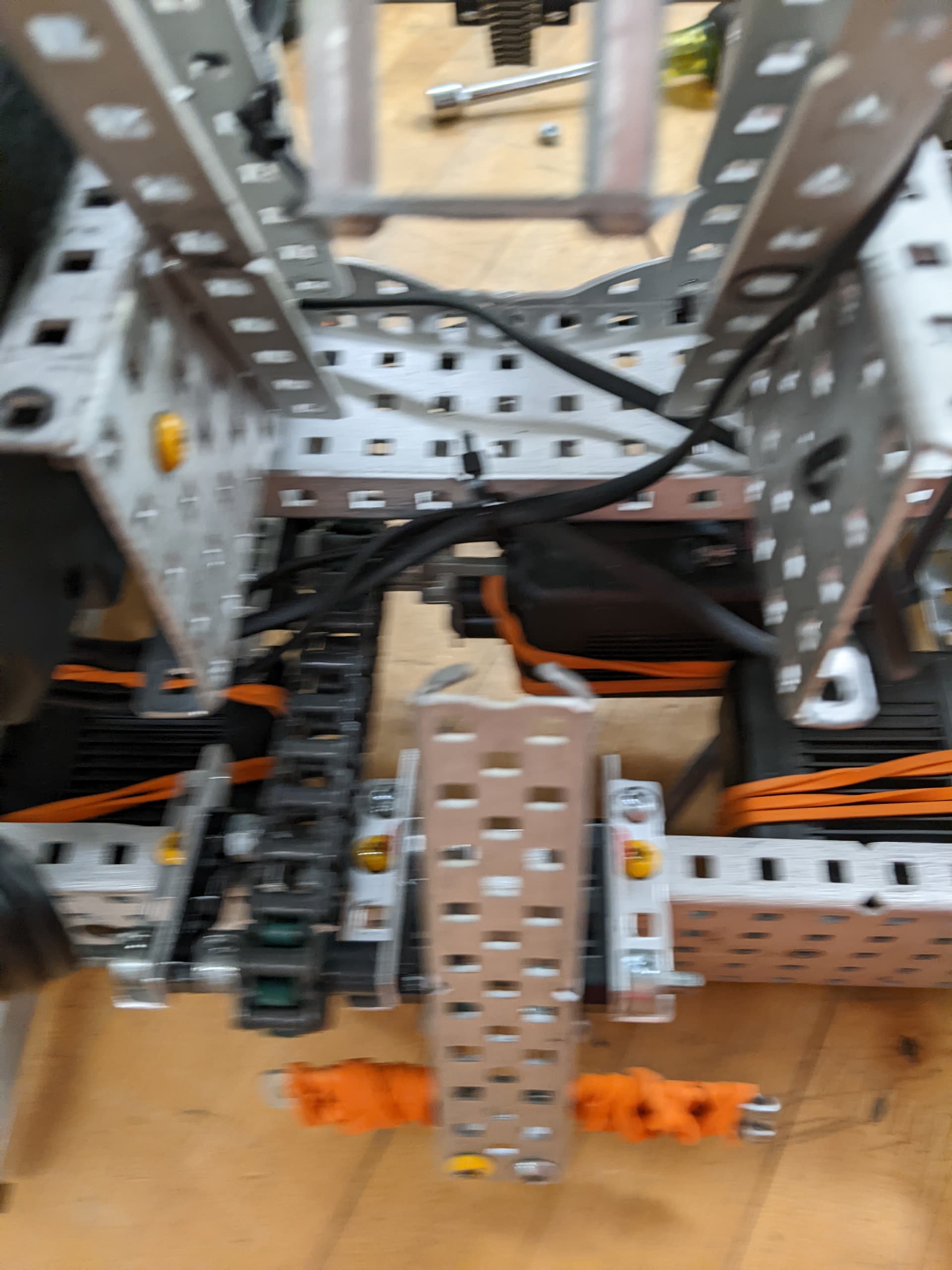

We have a six motor drivetrain and use a regular motor with a red cartridge for this clamp.
The motor is located behind the clamp and it’s better seen in the second photo.
