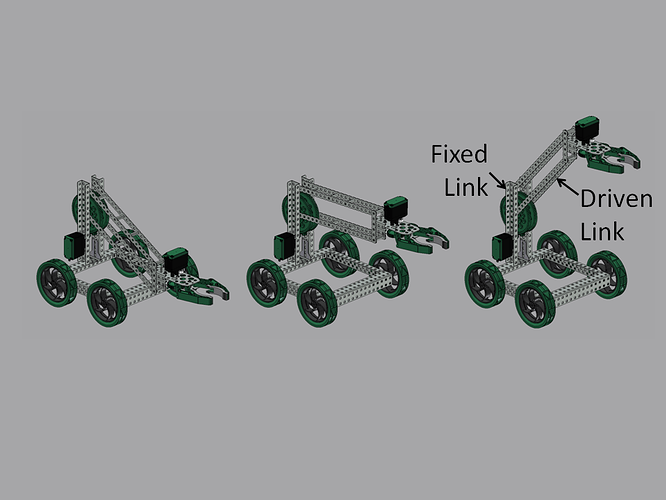

So I searched a bit more, does this 4 bar design https://www.vexforum.com/uploads/default/original/2X/0/0cf75d14a5ba60daaca1b942ae8ec00099113efb.png resemble the one you’re suggesting?
yes, that would be a 4 bar linkage.
very simple, but also quite useful.

A 4-bar would be amazing. You could get way over 17" very easily with one.

Most efficient lifting mechanism would be an (overly complicated) DR4B like the game “In The Zone,” but that is insanely overkill.
Especially for stacking, you’d want a 4-bar. Cascade lifts(forklifts) can be efficient, but usually they are slower than 4-Bars. (Albeit they do lift linearly, unlike the 4-bar)
This sounds like Skyrise, and, if this was a game for the general community, you would see a lot of those designs. (Which are way too complicated for such a small project)
I would definitely Spring for the 4-bar with a small clamping claw to grab the cubes. I would also fear it down for torque to keep it as accurate as possible, at the expense of some speed. (Or just have 2 buttons to control it; one full speed one and a slower speed used for fine tuning)
