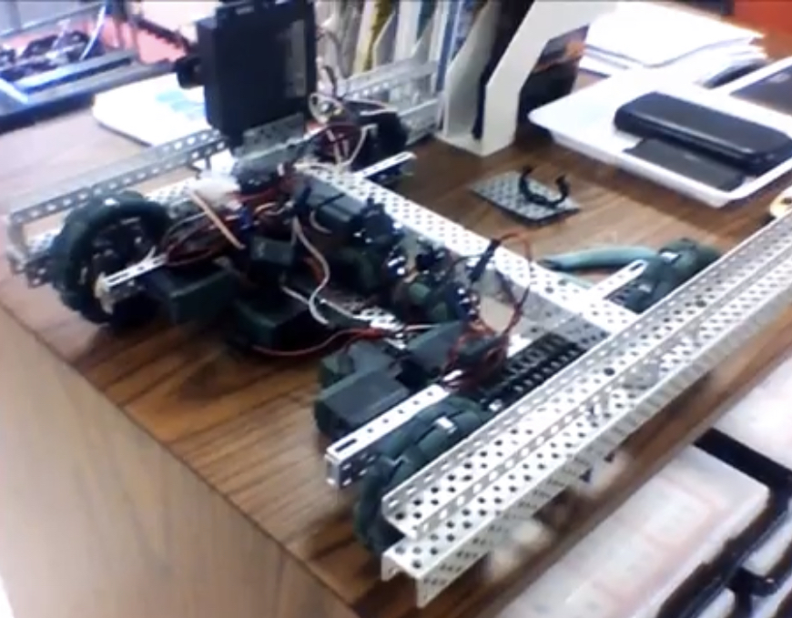

Hey all,
My team is considering building a 3 motor H-Drive design for TT this year: I’ve been looking around for some good H-Drive (with a strafing Omni wheel in the middle) designs used in VEX over the years, but I haven’t really seen any high-quality designs that show the ideal function of an H-Drive with a strafing Omni. I was curious if anyone has seen a really well built and well-used H-Drive for any of the past challenges (or for TT!) and could link a photo or video for us to look at to figure out why their design was so successful, or if the lack of documented strafing H drive designs says something about our building a strafing H-drive in the first place, and that we should reconsider our drive choice.
Any advice/guidance on this matter would be great.
Thanks!

We tried building a h-drive and it was really unreliable. I would suggest using x-drive, which is better in almost every aspect. If you have to use an h-drive, I would suggest making a pivoting h-drive so the wheel is always in contact with the ground. That is what some FRC teams do, and it works really well. Here is a picture of what I am talking about (you don’t have to use 2 motors).
download
Here is a video of the system working. Robowranglers 2014: Vader - YouTube At 0:36.

This robot is very compact but it probably will be a challenge with the V5 motors, but here’s a very nice H-Drive
