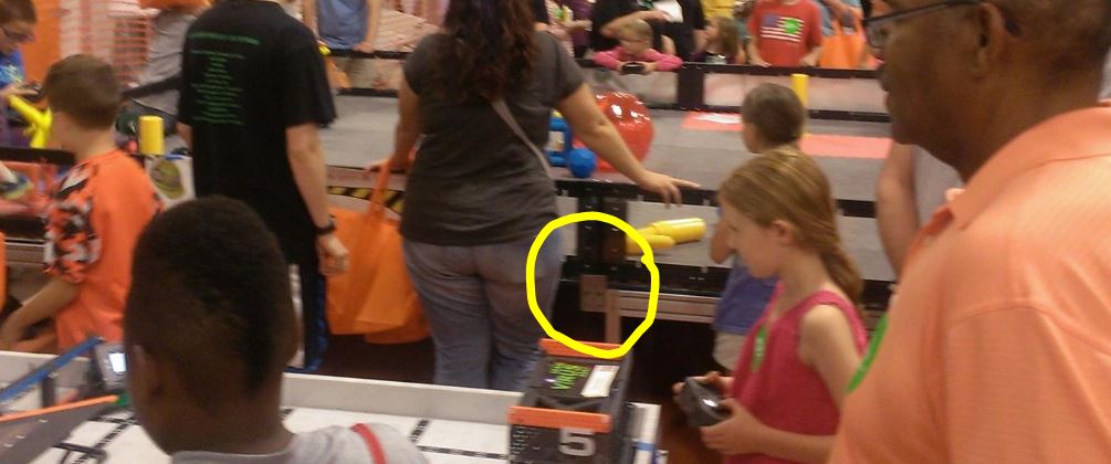

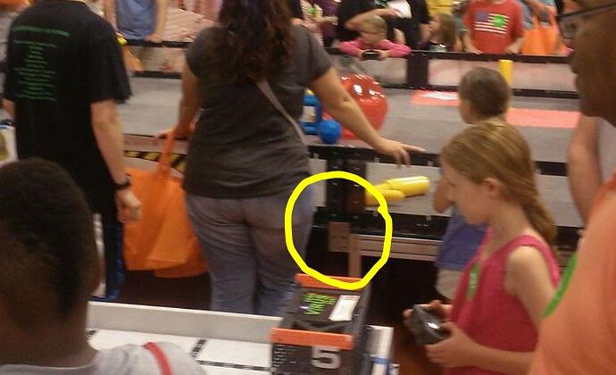

We use 1/16" flat steel plates (about 4" x 4") around the edges of the field, 2 per side, to hold the walls from falling off the platform. We don’t actually anchor the perimeter at all. The picture shows one the the plates circled in yellow.

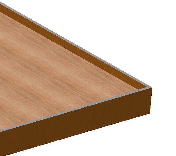

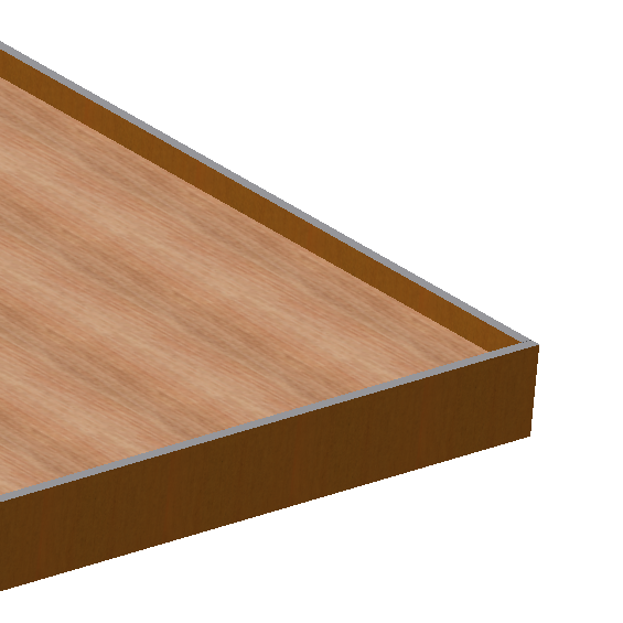

What if you wrap the perimeter your stage with a 1x6 leaving 2" above? You would have 4" to attach the board to the sides of the stage and the field would set into a tray.
