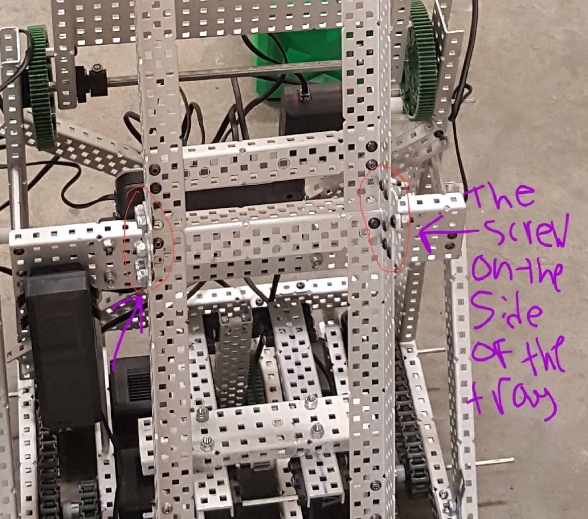

So my team has a tray bot. Whenever we take in cubes they keep on getting stuck on the screws that are attached to the tray flip out mechanism. I know that shoulder screws would be a good option to get the screws to be more flush with the metal, but we don’t have any. I have heard that some teams have countersunk the holes, but how do you do that? Does anyone have other ideas to get screws to be more flush with the metal.

The screws in the middle of the tray is where the cubes get stuck
Sorry to ask again, but could you take a closer picture of the problem areas? I dont see anything wrong from here.

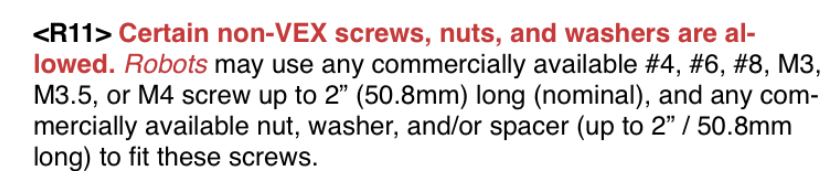

To answer the OP question, you use a countersink bit. Drill the square hole round first, then get some 8-32 flat-head screws. https://www.amazon.com/IVY-Classic-09050-Countersink-82-Degree/dp/B0050PUD3Y/
Countersinking the holes will increase depth for the screw head but are non vex official 8-32 flat head screws even allowed?
image Yes
clarifies this

So the screws that are attached to the side of the tray is where the cubes tend to get stuck.

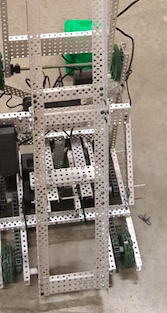

Is your tray 5.5 inches wide or 6 inches wide? Mine is 6 inches so there’s leeway for screws on the inside of the tray without disturbing the cubes
Judging by the number of holes (12), that tray is 6" wide.
Well if it is 6 inches wide could @ItsMe so kindly provide a video of the cubes getting stuck? I’m a bit dumbfounded here since my tray doesn’t have any issue despite being lined with screws on the inside.
20190827_224451
My tray is a little less than 12 holes wide, and I think your tray is a little more than 12 holes wide. I don’t really know the measurements in inches, but my tray is narrower than yours. I don’t have robotics until tuesday so I can’t really get a video now.
That’s most likely the problem then. If your tray is narrower than mine, then the cubes are probably stuck because there isn’t enough width. If that’s the case, then you’re probably going to have to make your tray one hole wider. Remember when building mechanisms: (not that it necessarily applies here) when your mechanisms dont perfectly fit into the holes, then round one hole up and use extra spacers.
Making the tray one hole wider is a great solution, but would it also be possible to sand down the head of the screws to make it more flat and flush with the tray.
Yes, definitely possible, but I would still advise making it one hole wider.
