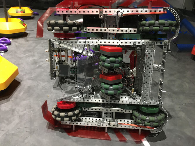

My team can’t keep rings out of our wheels from the back. We have pieces of metal surrounding each side except for the back because we have a forklift-like thing on the back, and can’t put metal there. Do y’all have any suggestions on how to keep the ringles out or the way you did it?

My team isn’t super worried about keeping them out completely, just keeping them off of the end of the c channels we use for our tank drive, and from getting them stuck underneath the robot. We ended up enclosing the end of our tank drive with metal pieces and put some thin sheets on both sides of the cross section. These effectively make it so that rings wont get trapped underneath or on the wheels or drivetrain.

Put two cam followers in front of each wheel. If you do that they will retract and you can still go up the ramp
Our A team used L-channel to create a stop for the rings that ran along the entire back of the drive base.
Our B team used lexan on the front and used aluminum plates on the back.
And our C team used L-channel with grooves cut out for the wheels.
Polycarb is probably the best way to do this. It’s easy to control and ensures that (if done properly) you are still able to climb the platform, which can be an issue with just using c channels.
My team uses a “standoff skirt”. We have 3/4" standoffs screwed in once every 3 holes all the way around the bottom. Another idea we had was to use standoffs to hold a bar underneath the frame in order to use less standoffs.

We also use these. I saw a well-built claw bot use these at a competition to keep out rings. We use these in reverse on our back, so there is a bar going under the drive motors, with these and longer ones sticking out the top, in between the motors. Thanks!
