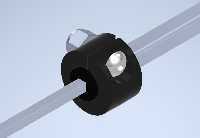

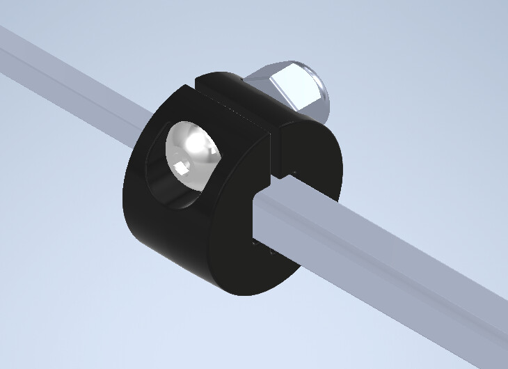

There is a way to make a HS to LS conversion, you use a HS shaft collar and put half it onto the axle, then on the other side you use a Metal axle insert, then you just put a LS axle in there and tighten the HS shaft collar. In the end it should look something like this.
