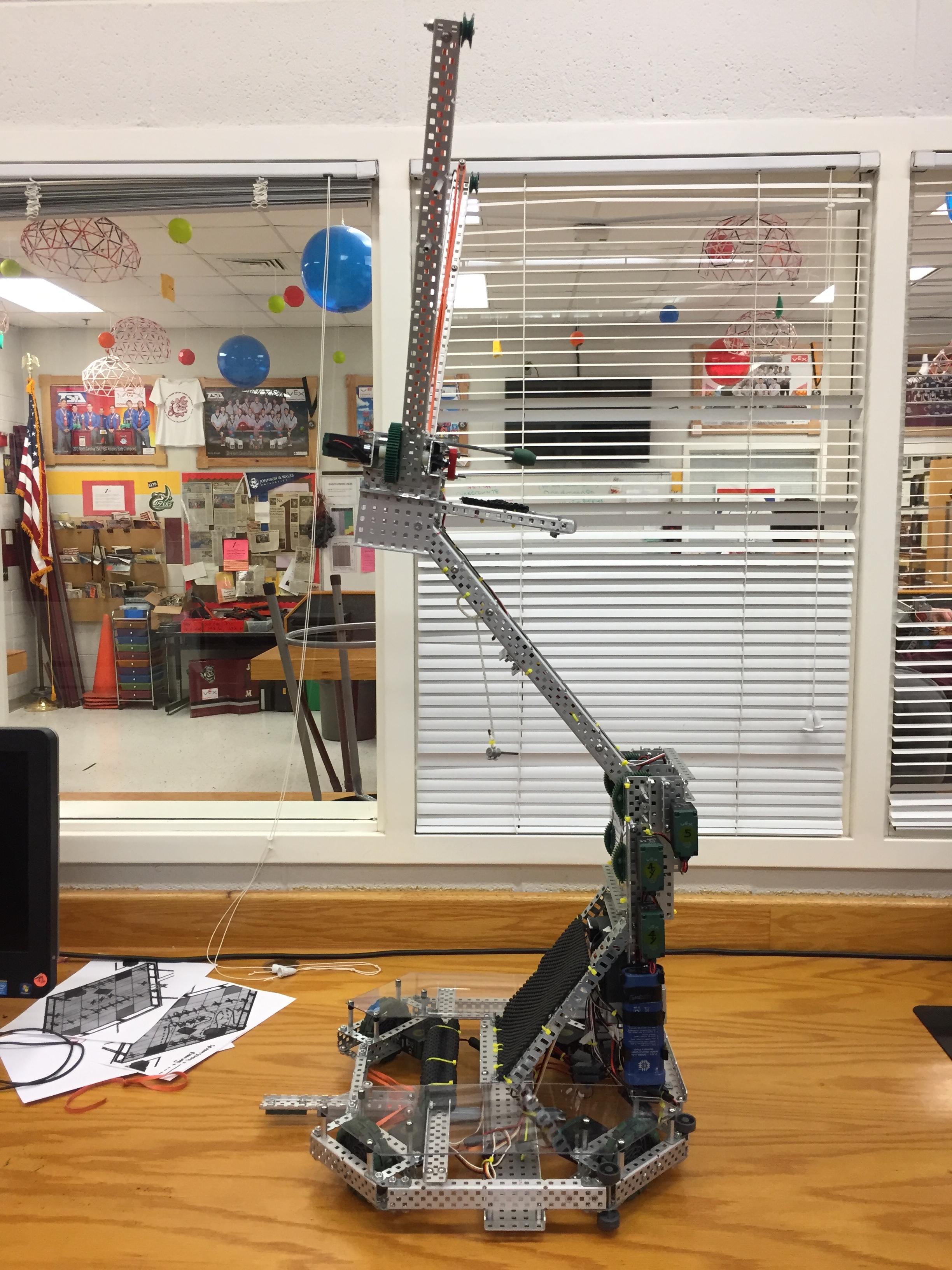

I’ll have weight on Wednesday… mostly Aluminum though. Could be motors over heating. May have to go to high torque internal gearing on drive motors. Photo attached.

Ok, so 3.25 inch wheels changes your drive ratio from 2.24 x 3.25 (smaller omni) /4.0 (standard omni) = 1.82 current ratio.
We have changed our 4 motor tank drive ratio from 1.6 to 1.3 because we could not push or drag objects at all without burning motors. The 1.6 drive ratio contributed to us burning the drive during back-to-back elimination matches, hence the change.
If you change to torque motor gearing, your effective ratio will be 1.14. This will be very reliable but perhaps too slow for your liking? Some teams really prefer to ensure the reliability, but 4 inch wheels with torque gearing may give you a better balance between reliability and speed.
Really your final gear ratio depends on whether you want to be able to push objects or not. Your current 1:1.82 gear ratio should work for anything under 14ish pounds, but not reliably and you won’t be able to push anything. In the picture I see some (not very much) extra c-channel that should be removed. Try a weight loss program for your robot; anything extra that you don’t need should be cut. One piece of cross bracing across your robot is enough; if you feel it’s necessary avoid 5x c-channel. Triangulation pieces could be shorter abd provide pretty much the same amount of strength; the 5x c-channel that connects your claw to the arm could be shorter too. Remove those plates of lexan and replace it with rubber bands. Little things add up. Just be sure not to remove anything that’s actually necessary.
Weight came in at 15.5 lbs.
we changed the internal gearing from high speed to high torque. This seems to have solved our motors cutting out and the speed really isn’t that bad.
