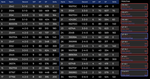

  • Shows all rankings and skills on a single page with no scrolling.

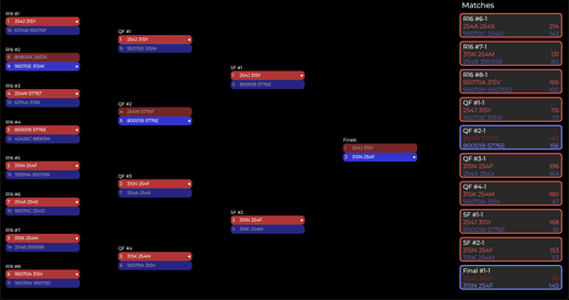

  • During eliminations, automatically switches to an elimination bracket which fits all on one screen.

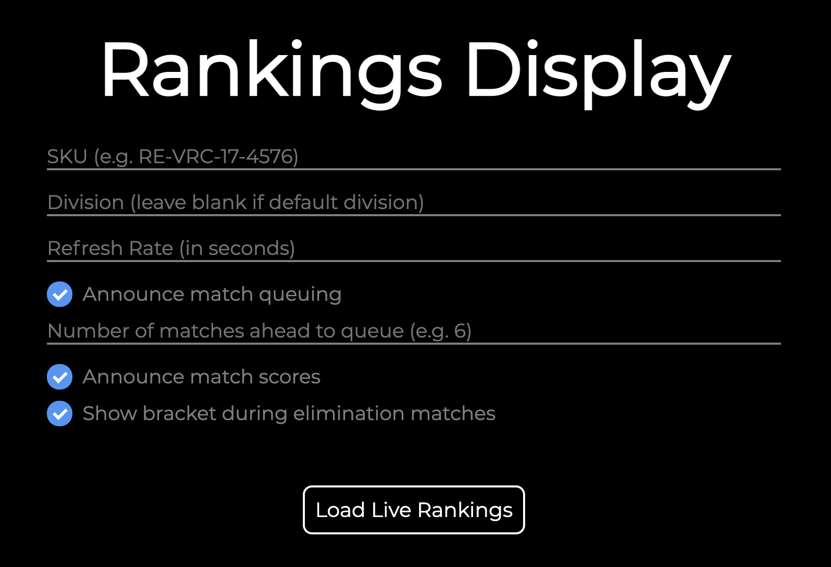

You can configure this tool on the configuration page.
  • Enter the SKU (RobotEvents ID) of your tournament
  • Enter a division (if applicable) - most likely you can leave this blank.
  • Enter a refresh rate (ideally, not lower than 60 seconds).
  • Select whether you would like to announce match queuing and scores.
  • Enter the number of matches in advance to queue.
  • Select whether you want the elimination bracket to automatically begin showing during elims.

Rankings display:
Elimination bracket display:

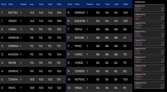

Just made some changes that allow it to work for IQ tournaments as well. It works the same way - by passing in the SKU of an IQ tournament. Here is an example: https://team315.org/rankings.html?sku=RE-VIQC-19-0356&refresh=500&queue=&announce_queueing=true&announce_scores=true
Hope you find it useful :slight_smile:. I’m not too familiar with what would be useful for IQ, but let me know if this seems about right.

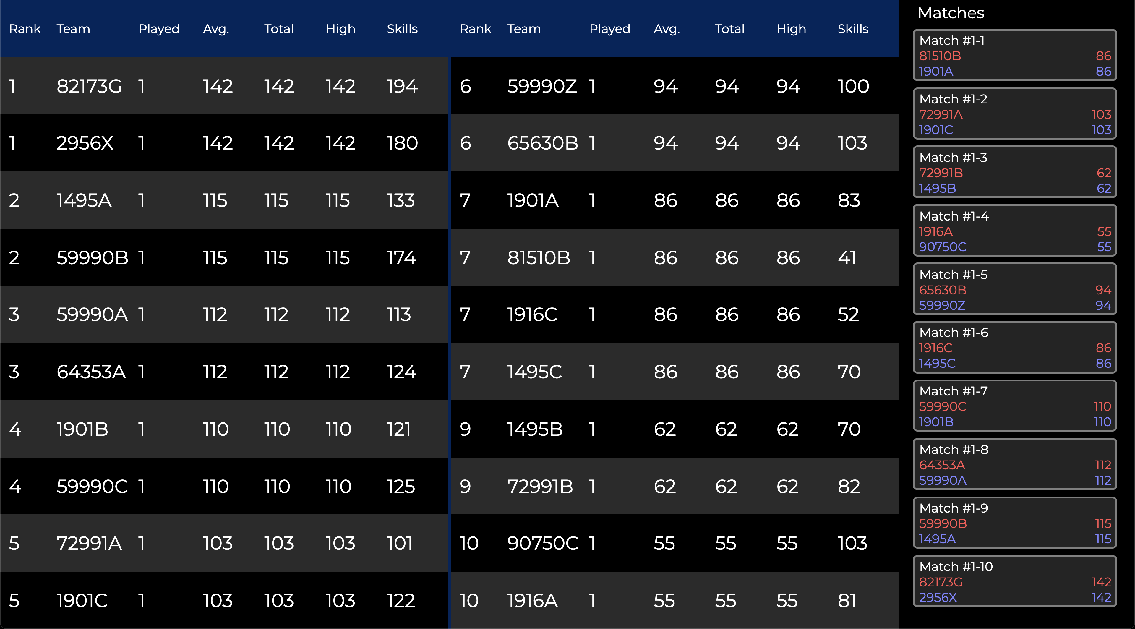

Regular rankings (which I obtained even after the event moved to final rounds by choosing the config that causes it to show regular rankings only):
Finalist rankings:

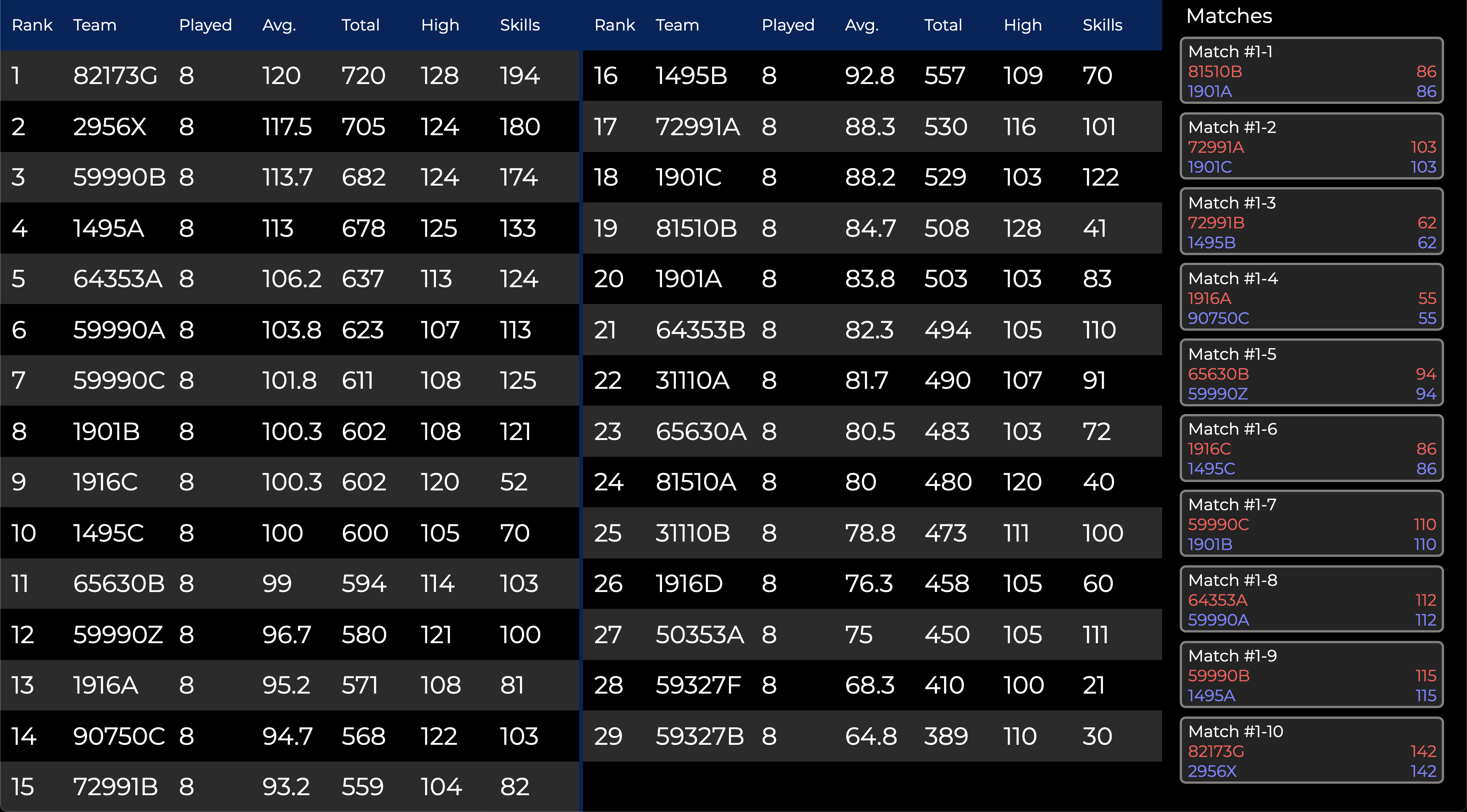

That’s fantastic. Really nicely done. I like how the text resizes based on the number of teams. I think WPI was one of the larger events held this year in terms of number of teams, and the site handles it very nicely:
https://team315.org/rankings.html?sku=RE-VRC-21-4971&refresh=&queue=&announce_queueing=true&announce_scores=true&show_elim_bracket=false&show_averages=true
Thanks – in fact it may be even better if I were to do a 3-column display when there are that many teams :slight_smile:.

Do you mean on the configuration page? Would you be able to provide an screenshot? Thanks.
Thanks for the feedback! Regarding making the chime optional, I will add that in – shouldn’t be too much work. The reason for the proceed button is for the Chrome TTS to work, it requires a user interaction with the page. It seems like any keypress should work, so I will work on adding this in too. Hopefully will have this done within a week or so!
