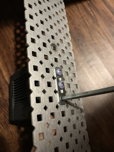

Better bearings
Basically you just drill a hole in the square hole on a lock bar to make it.
It considerably skinnier and should make axle joints more viable. It has roughly the same amount of slop normal bearings have and have way less friction. Due to it being metal instead of plastic.
I don’t really see any cons of it but if there are any please tell me.

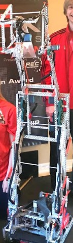

So many people on the discord and the forums really love pushing ideas to the grave. But I have to be honest that its not even suprising anymore, and for that reason I want you @9935E to know to ignore quite a lot of these opinions and understand its potential. Your idea is quite interesting, I did something like that on my VEX ITZ robot’s translation mechanism:
unnamed
You probably can’t see it, but I utilized such an item to hold the 12 tooth gear as a low profile bearing flat on the translation gearbox on the left side of the robot. Friction was so little it allowed my translation mechanism to work with only one motor, which allowed me to make finals in South Texas States and make it to the VEX World Championship back in 2018. Your idea about that has extreme potential as something that is almost frictionless and low profile, allowing you to add compact gearboxes and make advanced mechanisms (provided that they don’t require too much torque).

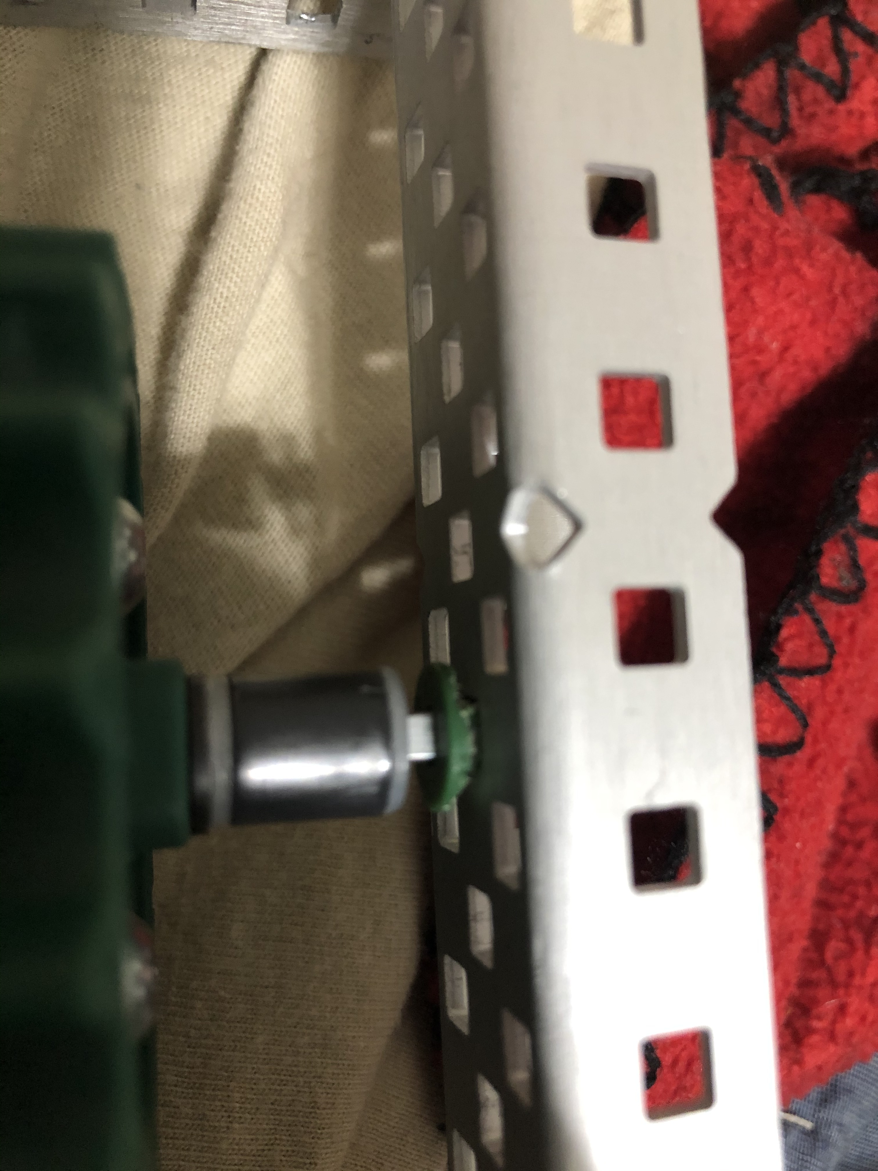

If you want smaller bearings use green insert bearings. Theyre even smaller than this design and they’re plastic so they have a significantly less CoF
edit: here’s a pic of what I mean. You have two ways to make them- drill and file a square hole in c channel and push the inserts in, or sand/file the inserts themselves to fit snug in the c channel holes. I recommend the second option. Do note that these bearings should be drilled out, just to ensure their ID is the same. Vex has poor tolerances on these. But after that is done, you will have very nice compact and reusable bearings.

the green insert bearing are definitely better. less friction, less slop, and just as low profile. I would use these if you need a low profile bearing.
